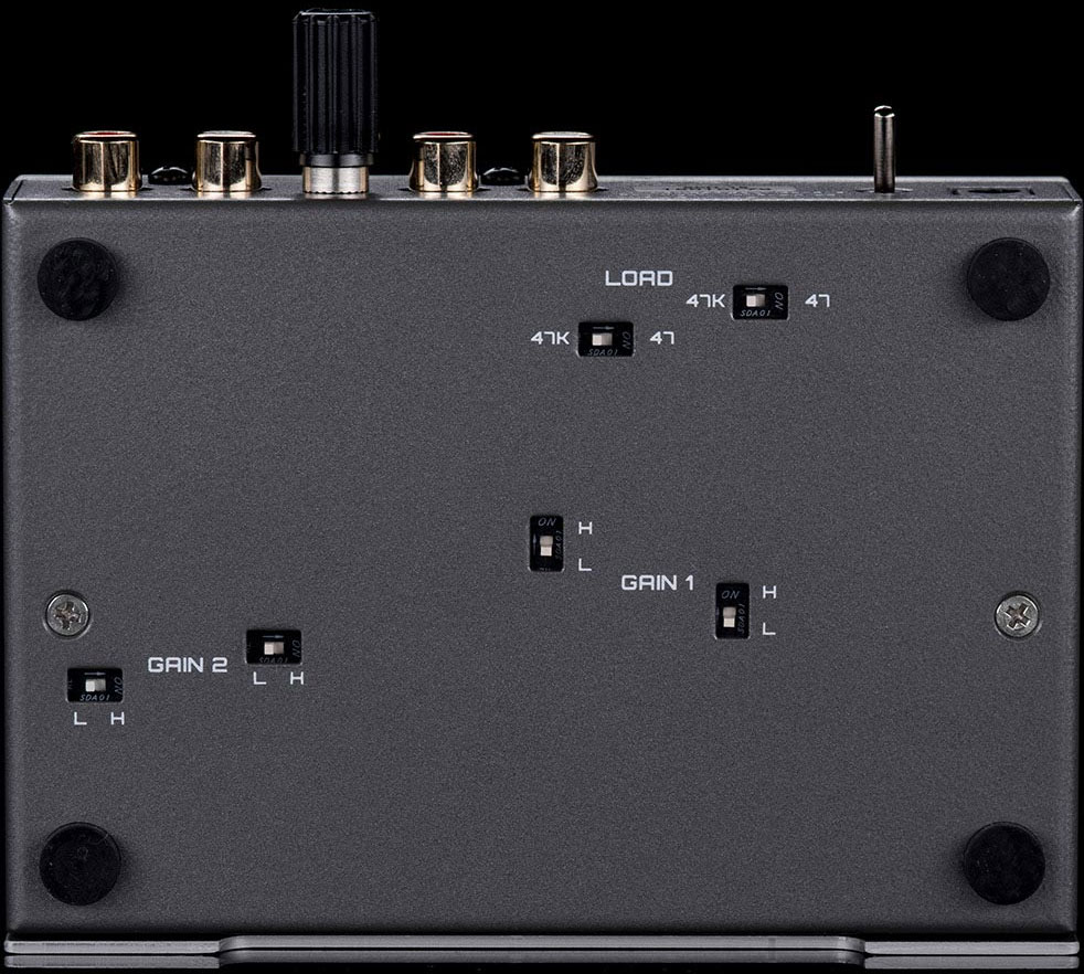

Specification:
Gain 1 = L, Gain 2 = L (Decca Mode)
Gain: 30dB
THD: <0.005%, A-weighted, at 1V RMS SNR: >90dB, A-weighted, inputs shorted
Crosstalk: -75dB, 20-20kHz
Sensitivity: 9mV for 300mV output
Overload Margin: >20dB
Gain 1 = L, Gain 2 = H (Standard MM Mode)
Gain: 42dB
THD: <0.008%, A-weighted, at 1V RMS SNR: >82dB, A-weighted, inputs shorted
Sensitivity: 2.3mV for 300mV output
Gain 1 = H, Gain 2 = L (Low Output MM/High Output MC Mode)
Gain: 48dB
THD: <0.01%, A-weighted, at 1V RMS SNR: >80dB, A-weighted, inputs shorted
Sensitivity: 1.3mV for 300mV output
Gain 1 = H, Gain 2 = H (MC Mode)
Gain: 59dB
THD: <0.03%, A-weighted, at 1V RMS SNR: >70dB, A-weighted, inputs shorted
Sensitivity: 0.3mV for 300mV output
Input Impedance: Selectable 47 ohms (typical for MC cartridges) or 47k ohms (typical for MM cartridges)
RIAA Accuracy: +/- 0.2dB, 20-20kHz
Output Impedance: 75 ohms
Topology: Fully passive RIAA network with ADA4897 and AD8066 gain stages, thin-film resistors, and film capacitors throughout
Power Supply: “wall wart” style 16VAC transformer, regulated +/- 5V rails
Power Consumption: 4W
Size: 5 x 3.5 x 1.25”
Weight: 1 lb
*All measurements made on a Stanford Research SR1+ Audio Analyzer
Price: $129
