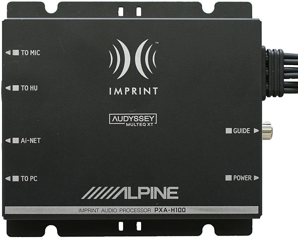

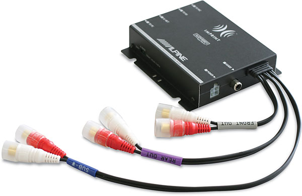

Και κάτι τελευταίο....
Αν έχεις τα χρήματα αργότερα, συνδέεις πάνω στην πηγή και το PXA-H100 (ψηφιακός επεξεργαστής ήχου)
30.532
49
Απάντηση: Γνώμες για πηγή!!!

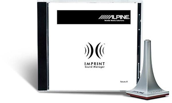

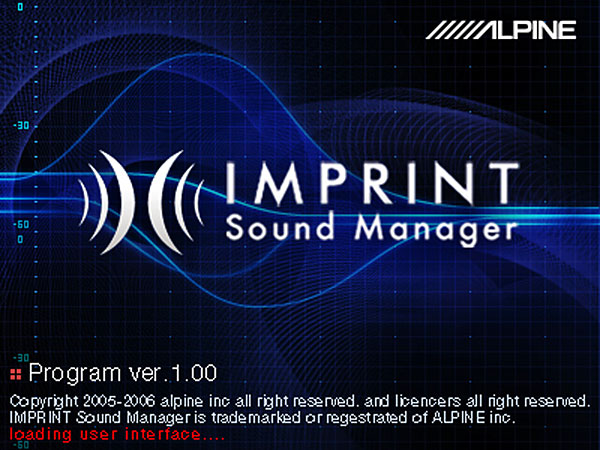

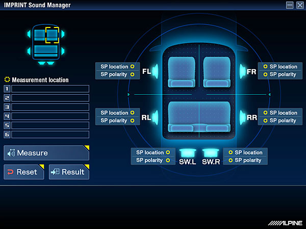

Many cars have acoustic problems that interfere with an in-dash receiver's ability to produce clear, well-balanced sound. Your receiver's equalizer may help, but Alpine offers a better way. The PXA-H100 IMPRINT Audio Processor plugs into the Ai-NET input on most 2008 Alpine receivers, analyzes your vehicle's acoustics, and uses the MultEQ feature developed by Audyssey Labs to adjust the receiver's output for the best possible audio performance.
Easy to use
In order to use the IMPRINT, you'll need to purchase Alpine's KTX-H100 tuning kit. Connect the microphone from the KTX-H100 tuning kit, then load the supplied software onto your laptop PC. Use the the included USB cable to connect your PC to the PXA-H100, then use the software to tailor your sound.
Read More
Automatic adjustment
The PXA-H100 analyzes over 500 soundwave points to produce a perfectly corrected sound curve for your vehicle and then saves it safely in its memory. The entire tuning process only takes about 10 minutes. You can use the PXA-H100 with your Alpine's built-in amplifier or with external amps in your system.
Sonic toolbox
If you want to get hands-on, the PXA-H100 also features a 5-band parametric or 7-band graphic equalizer, manual crossover controls, and manual 6-channel time-correction controls as well. The PXA-H100 provides a pass-through connection, so you can still add other gear to the Ai-NET bus. It also adds three sets of 4-volt preamp outputs plus Alpine's sound-correcting MediaXpander function to your receiver.
Details:
  • audio processor for use with most 2008 Alpine Ai-NET receivers
  • IMPRINT sound technology adjusts receiver output to match vehicle acoustics
  • manually adjustable 5-band parametric or 7-band graphic equalizer
  • high- and low-pass filters
  • MediaXpander restores sound quality lost during recording or transmission
  • 6-channel, 4-volt preamp outputs (front, rear, subwoofer)
  • requires Alpine KTX-H100 tuning kit for full functionality
  • warranty: 1 year

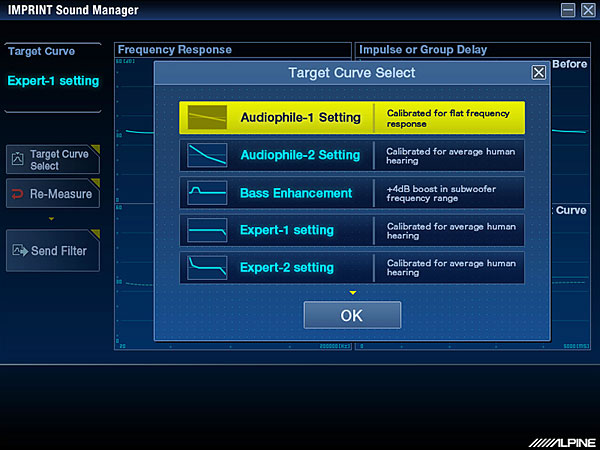

Sound Processing
Imprint: By adding this PXA-H100 Imprint box and the KTX-H100 tuning kit (item number 500KTXH100) to a compatible Alpine head unit, a car's inherent acoustic shortcomings can be overcome with the MultEQ feature. Imprint also gives you much more sound adjustment flexibility as detailed below.
MultEQ: MultEQ, developed by Audyssey Labs, automatically optimizes the audio for the listening environment inside your vehicle. The Imprint box and tuning kit include the hardware, software, and microphone necessary to measure multiple positions in the car and capture frequency and time domain information from the vehicle's actual acoustical environment. Once the car's speaker location delays are measured, along with the frequency peaks and dips caused by the absorptive and reflective materials in the interior, MultEQ creates a set of equalization filters to correct the frequency response and time domain problems for each speaker in the vehicle. It also removes sound distortion caused by the specific acoustical problems in the vehicle by applying unique FIR filters, using more than 500 points along the frequency spectrum per channel. This optimizes the sound reproduction to the specific vehicle listening environment with much greater precision than can be achieved using typical graphic or parametric equalization. The result is a more accurate soundstage and smoother, more natural sound optimized to match your vehicle.

Υπολόγισε γύρω στα 200-250€ το Η100 με το (ξεχωριστή αγορά = MultEQ Tuning kit for PXA-H100) μικρόφωνο ισοστάθμισης!! :107:
