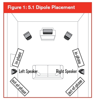

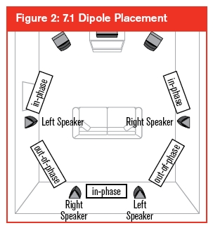

If you are using dipoles for the rear speakers as well as for the side speakers, pay attention now!
Remember when you installed your side surround dipole speakers? They have a “+ “ side and a “-“ side. You oriented them so that the “+” of each speaker faced towards the front of the room.
So here’s what you need to do when mounting dipoles on the rear wall to go along with dipoles mounted on the side wall: Switch the Left and Right surround speakers and mount them “backwards” on the rear wall. In other words, the Right speaker will be on the left side of the room and the Left speaker will be on the right side of the room.
Why?
Here’s why: By swapping the rear surround speakers, the rear-firing “-“ of the side surround will blend right into the out-firing “-“ of the rear surround. Then the two inward-firing sides of the rear surrounds will both be “+.” Then the out-firing side of the other rear surround is “-“, and it will blend seamlessly into the rear-firing “-” side of the other side surround speaker. Everything sounds nice and smooth, very realistic and convincing, with no abrupt, unnatural changes in the sound field.
This is pretty subtle stuff, but it’s these kinds of little things that make the difference between good-sounding and great-sounding systems.
Με δυο λογια.
Αν θα βαλετε διπολα πισω και εχετε και διπολα στο πλαι, τοτε, θα πρεπει να βαλετε το δεξι αριστερα και το αριστερο δεξια.
Δειτε τους πινακες.
