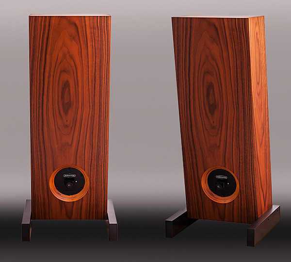

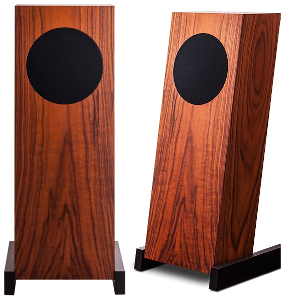

The Osiris's eye-catching 10-degree rearward slope gives it a windswept look recalling to my crusty memory the "blown away guy" from Maxell's print and television advertisements of the 1980s. The Osiris's proportions—it measures 33.5" high by 14.25" wide by 14.56" deep—reveal it for what it is: a small floorstander that should fit well in most living rooms.

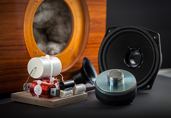

"The port is a hybrid between a classic bass reflex design and a horn," Friedl explained. "We use the floor as part of the system, so the alignment is not so dependent on the room. It's a very efficient solution. But much smaller than a real horn construction."

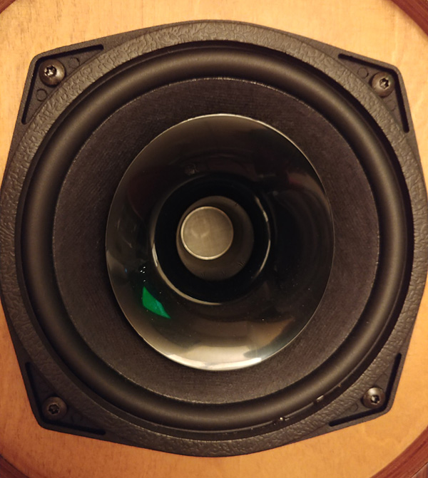

Description: Coaxial-driver, vented, floorstanding loudspeaker. Drive units: 6.5" paper cone woofer, coated with oil lacquer. 1" horn-loaded coaxial compression tweeter driver with titanium diaphragm. Frequency range: 38Hz–30kHz. Sensitivity: 88.7dB/2.83V/1m. Nominal impedance: 8 ohms.
Dimensions: 33.50" (850mm) H by 14.25" (360mm) W by 14.56" (370mm) D. Weight: 55lb (25kg).
Finishes: Walnut natural, walnut amaranth, walnut blazed.

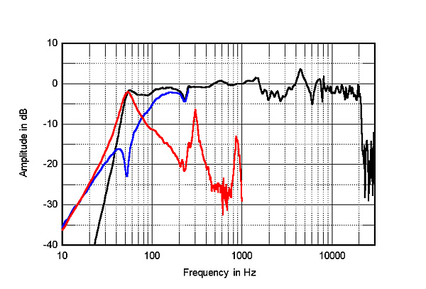

Trenner & Friedl Osiris, anechoic response on tweeter axis at 50", averaged across 30° horizontal window and corrected for microphone response, with the nearfield woofer (blue) and vent (red) responses and their complex sum (black) respectively plotted below 270Hz, 1kHz, and 270Hz.

Horn/Reflex bass alignment for ideal room matching
Finest crossover components by Mundorf
Coaxial loudspeaker principle; point source, smooth phase and perfect step response

1 x 6.5” Paper cone, coated with oil laquer
1 x 1” Horn loaded coaxial compression driver with titanium diaphragm
