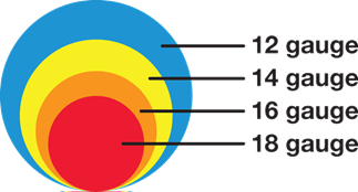

Wire thickness is identified by its American Wire Gauge (AWG) number. The lower the gauge number, the thicker the wire. Thicker wire presents less resistance to current flow.
Relative thickness of wire gauges, drawn to scale (not actual size).
Thick wire (12 or 14 gauge) is recommended for long wire runs, high power applications, and low-impedance speakers (4 or 6 ohms).
For relatively short runs (less than 50 feet) to 8 ohm speakers, 16 gauge wire will usually do just fine. It’s cost-effective and easy to work with.
δηλαδη να δω για 12 gauge για ολά;
μηπως θα ηταν προτιμοτερο, για να ειναι πιο ευκαμπτο, να παρω 14 ή και 16 gauge για τα surround speakers που ειναι πιο μακρια (6+ μετρα);
και χοντρο 12 awg για τα Left Right και center;
