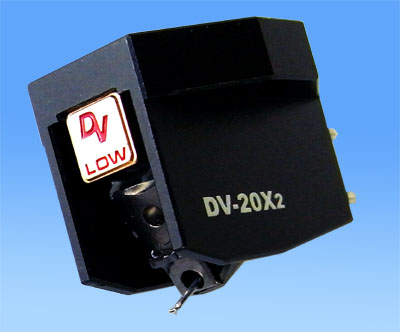

- καλημέρα , πολύ καλή η πρόταση του σνφορουμίτη ( Νίκο γράψε εάν θες περισσότερα ) , εγώ πάλι μή γνωρίζοντας τις απαιτήσεις σου και το σύστημά σου προτείνω μία κλασικά καλή κεφαλή ( σύντομα θα αντιπρωπευθούν πάλι στην χώρα μας
High/Low Output with Hard Aluminium Cantilever
Description
For more than 35 years Dynavector have established an enviable reputation for producing affordable high quality moving coil cartridges. Notably high output models that are designed to work with MM inputs negating the necessity for equipment change or the use of setup devices required for low output cartridges. The outstanding performance of the Dynavector high output moving coil cartridges can be attributed to the exclusively Dynavector designed coil winding machine capable of utilizing extremely fine coil wire providing a high output to mass ratio.
Features and Improvements
DV-20X has a solid aluminum alloy body and a rigid magnet construction similar to XX-2MKII. The cantilever is a 6mm length of hard aluminum pipe with a Micro-Ridge stylus. The magnetic flux damping and softened magnetism along with powerful neodymium magnets gives the 20X2H a healthy 2.8 mV output - suitable for most MM inputs. The 20X2L has an output of 0.3 mV ideal for most MC phono stages.
Both high and low versions of their 20X2 are available ensure for the optimum end result. The high output model is well suited to valve preamplifiers or electronics that only offer MM inputs whilst the low output version offers superb performance when combined with dedicated moving coil inputs.
SPECIFICTIONS
Type
High/Low output moving coil cartridge with flux damper and softened magnetism
Output Voltage 2.8mV / 0.3mV (at 1KHz, 5cm/sec.)
Channel Separation 25 dB (at 1KHz)
Channel balance 1.0 dB (at 1KHz)
Frequency response 20 - 20,000Hz (± 2dB)
Compliance 12 x 10-6 cm/dyn
Tracking force 1.8 - 2.2grams
DC resistance 150 ohms / 5 ohms
Recommended load
resistance
> 1,000 ohms / > 30 ohms
Cantilever 6mm length, hard aluminium pipe
Stylus Micro Ridge Nude diamond
Weight 9.2 grams
http://www.dynavector.com/products/cart/e_20x2.html
http://www.tnt-audio.com/sorgenti/dynavector_dv20x2_e.html

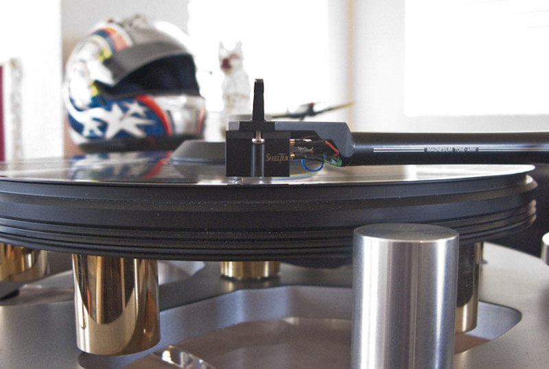

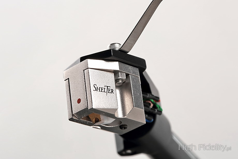

Εμεις αντιπροσωπευουμε τις Ιαπωνικες Shelter και Phasemation μπορειτενα ερθετε να ακουσετε μια απο αυτες η να διαβασετε τα review .
Οσο αναφορα το ματσαρισμα με το βραχιονα σας δεν υπαρχει προβλημα .
http://www.chameleonracks.com/en/shelter-κεφαλες-πικαπ-mm-mc
http://www.phasemation.com/product/pp-300.html
Δες φωτο απο set up με Shelter /SME V
