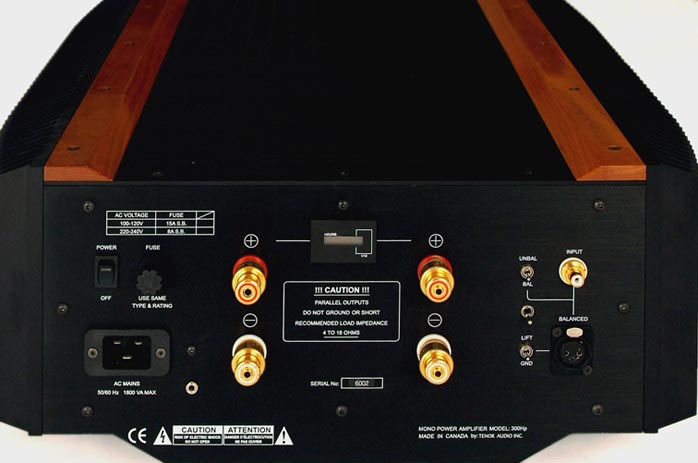

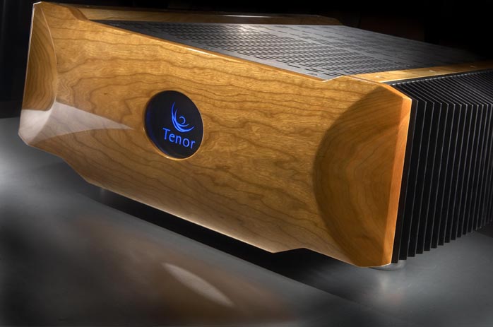

Ο λόγος για τους Tenor 350M των 60.000 ευρώ το ζευγάρι. Υβριδικός ενισχυτής με ιδιαίτερες σχεδιαστικές επιλογές (στην ουσία πρόκειται για OTL λαμπάτο με τα MOSFET αποκλειστικά σε ρόλο buffer) και απόδοση που θέτει νέα standards στην "cost-no-object" κατηγορία (αν πιστέψουμε το review φυσικά). Σύμφωνα με τον κατασκευαστή, έχουν δώσει ιδιαίτερη προσοχή ακόμη και στις βίδες που χρησιμοποιούν στους 350Μ.

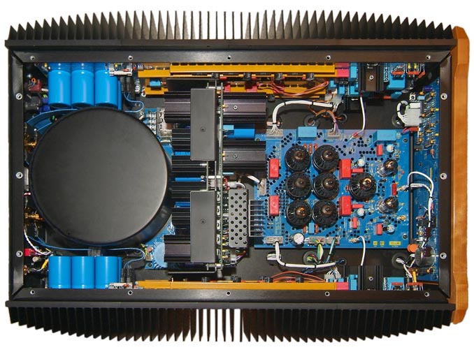

The 350M design at its simplest is a two-stage tube OTL voltage amplifier with a six-tube output buffer. The tubes form a functional mini amplifier within an amplifier, producing 13 watts at 500 ohms, which could actually power an appropriately rated speaker. However, since there are not many 500-ohm speakers on the market, there were three design choices:
  1. A traditional pure tube OTL amp. Michel did the calculations. To scale up the original 75-watt OTL to 300 watts required drawing over 2,000 watts from the wall - not a practical solution.
  2. An output transformer - a fatally flawed solution from Tenor's perspective. Yes, tube lovers always have that love-hate relationship with transformers. Looking for that big tight bass, you will need a big heavy transformer. But you also get lots of wire, stray capacitance, interference, nonlinearities and phase shift. Everything in life is a compromise so while top-of-the-line output transformers are good, they're also expensive, large and require very careful engineering.
  3. Finally, while MOSFETs are not perfect, they do not suffer from frequency and phase-related problems. In the 350Ms they supply no voltage gain. Their sole purpose is to provide current and convert 500 ohms to a more reasonable 8 ohms. Apply the corresponding mathematics, convert the power from the tube stage and you have essentially the output power of the 350Ms. This amplifier really is in many ways an OTL amp driving two large buffers.
The first gain stage uses two Tung-Sol ECC803/12AX7, the second gain stage a single JJ ECC99 followed by six GE 7044 buffer tubes. Although the 7044 is not currently in production, Tenor has been stockpiling them for over three years and claims to have a very large supply. Michel uses these tubes for what they do well - linear voltage gain as a driver.
The 350M is designed with no current limiting from the power supply to the output. The only limit is a small resistor calibrated for 1,200 watts at 2 ohms. The resistor has no effect dynamically but if you reach that current at 2 ohms, the protection circuitry will kick in before the fuse blows. The fuses do not limit current but open only if there is a malfunction. During two years of testing, Tenor reports no output MOSFET failures.
In total, there are 11 fuses in the amplifier; six of them monitored by the logic system.

τι τις ηθελε αυτες τι παλιομπορνες και rca ,επισεις μπλε πλακετα σορι αλλα δεν θα παρω :crazy_3:
