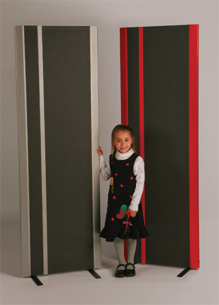

[DOUBLEPOST=1443821318][/DOUBLEPOST]ΜΑΓΝΗΤΟΣΤΑΤΙΚΑ
Magneplanar 3.7Freq. Resp.35Hz- 40 kHzRec PowerReadFrequently Asked QuestionsSensitivity86dB/500Hz /2.83vImpedance4 OhmDimensions24 x 71 x 1.625
