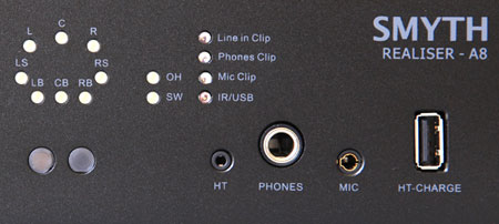

Many have tried, but few have succeeded in simulating a convincing surround soundfield with conventional headphones. Several years ago, I heard a demo of one such system from UK-based Smyth Research, and it really knocked my socks off. That was a prototype, but the technology, known as Smyth Virtual Surround (SVS), is now available in a commercial product called the Realiser A8.

SVS starts by "capturing" the HRTF of a specific individual—i.e., you—listening to a specific set of speakers in a specific room. You put a small microphone in each ear, and a series of test signals are played from the Realiser processor to each speaker. The resulting HRTFs are stored and used to re-create the effect of sounds coming from the modeled speakers in that room as heard by you.
http://blog.ultimateavmag.com/images/archivesart/smyth-mics.jpg
To fully optimize the system, the headphones must also be taken into account. So after the room measurements are taken, you put on the headphones over the mics, and more test tones are played to measure the precise interaction between the headphone cups and the listener's outer ear. The profiles of 64 rooms and 64 headphones can be stored internally, and as many as you want can be stored on removable SD cards.

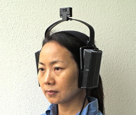

http://blog.ultimateavmag.com/images/archivesart/smyth-headtracker.jpg
After the measurements are stored, up to eight channels of analog audio are fed into the Realiser processor, which applies the selected HRTFs (room and headphone) and sends the processed audio to the headphones fitted with a small, rechargeable head-tracking device on the headband. That device sends an IR signal to a set-top receiver, which communicates the listener's orientation to the processor. This information is used to modify the HRTFs in real time so that the virtual speakers appear to remain in place as the listener's head moves.
