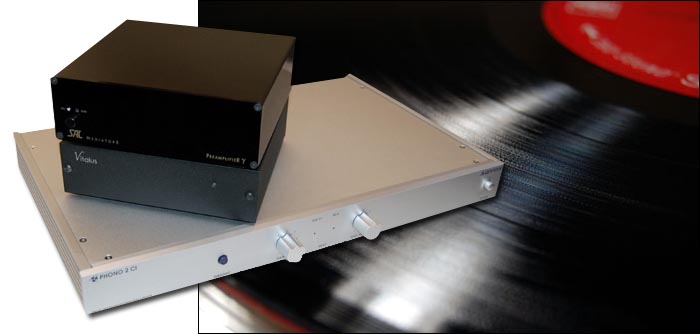

Holfi Viltalus €335; SAC gamma €649; Aqvox Phono 2 Ci MKII €949

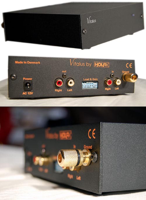

Holfi Vitalus:
Holfi's Danish Vitalus has served me respectably for quite a while. It's a classic black box: one input, one output, mice piano in-between. With all eight DIPs to off, the MM input is active (47kOhm/200pF). DIP 1+2 selects MC and various combinations of the remaining switches dial in one of eight different input impedances from 13 to 5,000 ohms.
There's no subsonic filter and an external power supply avoids radiation inside the main enclosure. Germany presently has no Holfi importer but the Vitalus can be procured through SWS-Audio for example.

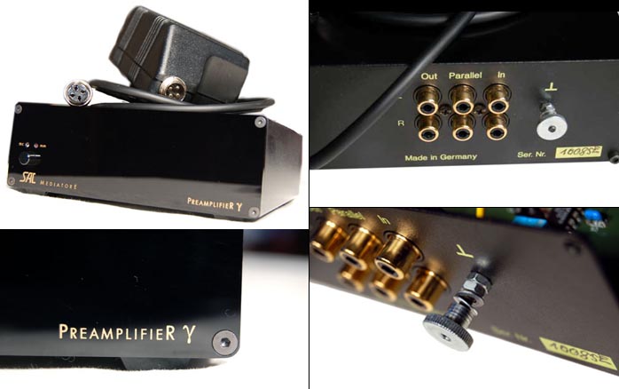

SAC gamma:

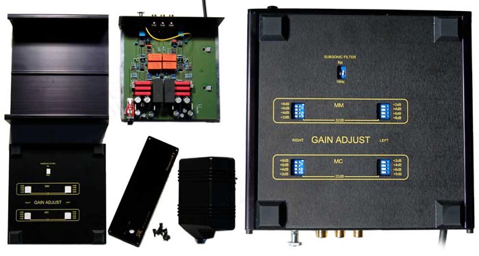

SAC's gamma received a face lift which is apparent belly up. Those little switches are new, enabling subsonic filtering and an MM/MC gain lift of up to 76dB. As does the Holfi, there's an external power supply whose 14VA rails (instead of 10VA) are scaled up.
"What about impedance and capacitance DIPs?" Nyet. For adjustments, refer to the parallel RCAs on the back. Each gamma is supplied with an order form for plugs that fix
desired impedance and capacitance. The customer simply provides either the values or the model names of the components to be used. SAC then supplies the custom fittings free of charge. Extra plugs cost 10 euros but Herr Axel Schäfer, chief of this Essen firm, contends that no adjustments sound best. Stock input impedance is 1k/47K for MC/MM respectively, with a frontal knob selecting between moving magnet and moving coil.
No further features. Or rather, one: Owners of older gammas are eligible for a 449 euro complete makeover which replaces all electronics. Incidentally, this upgrade program stretches across SAC's entire lineup. Rightfully proud, Herr Schäfer mentioned a 21-year old unit he recently received for overhaul modernization. That's a loyal fan club.

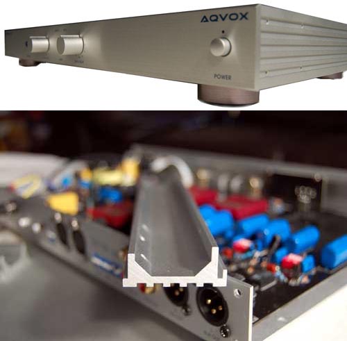

Aqvox Phono 2Ci MKII:
By comparison to the above, the Aqvox nearly conjures up a pilot's controls bay. Sorta. For sure, connectivity has advanced: two i/o ports each, balanced/XLR and single-ended/RCA. Gain, input Z and capacitance switches regulate the non-symmetrical input exclusively. Selectable impedance values are 100ohm, 1 and 47K. Internally switchable picofarad capacitance for MM is 47, 100, 220 or 470pf.
Around back, MM gain can be raised by 6dB, up to 20dB for MC. Incidentally, MM can only be had from the RCAs, MCs can take either input, with the maker clearly favoring balanced to benefit from "technological advances". How so?
Though merely three years on the market, Aqvox phono stages have nearly garnered classic status already, likely at least in part because of designer Carlos Candeias, perhaps supported by the pro aura which surrounds both machine and company Aqvox whose three-deep offering covers consumers and professionals alike. Occasionally, amateurs get hip to the fact that mastering engineers do use the good stuff, never mind don't always pay through the nose. Aqvox entered the market with the 2Ci for a mere 600 euros, which since has sadly been adjusted for inflation. The successor in MkII guise does weigh in with a serious power supply which, unlike with the other loaners, remains inside the main chassis where the Aqvox has more room to spare - on a separate board to be sure.
The current 950 euros charged (the upgrade from MkI to II is 300 euros) remain quite competitive for a fully balanced machine. Which naturally begs the question - is balanced really required? Aqvox responds with four bullets:

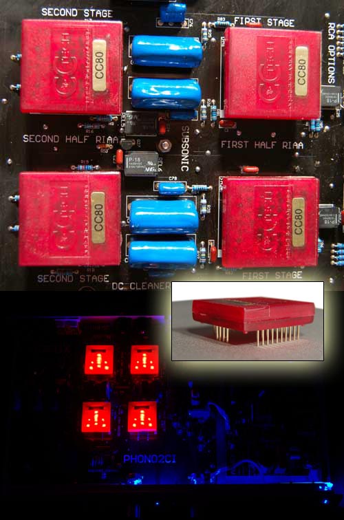

4. LEF
This pertains to the Candeias gain modules also seen with C.E.C. To combat transistor nonlinearities and concomitant nonlinear gain, Load Effect Free circuitry (a form of floating cascade circuit) avoids running the voltage and current load lines through the output transistors. This is claimed to linearize gain without global feedback while cleaning up the sound. Further details on this can be found here. All Aqvox components (i.e. also the D/A converter and microphone preamp) rely on LEF. The Phono 2Ci sports four Candeias ICs, one per channel and gain block. Any reason for the disco lighting above though?
