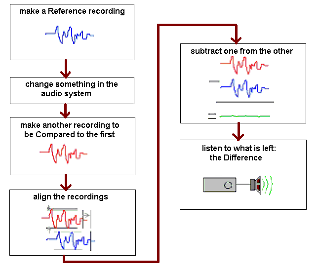

"The essence of the process is this: Record the output of an audio component when playing any piece of music, or even a test signal. Then change something in the system—a cable, an amplifier, any other component, or apply an audiophile tweak of any kind. Next, record the output again with the same piece of music or the same test signal. Then, using Bill Waslo’s “Audio DiffMaker” software (which has not been commercially released yet but can be downloaded in a trial version), align the two recorded tracks to the same gain level and timing. Finally, subtract one from the other and listen to the difference recording. If it is basically silent, then the change has clearly done nothing. No sound in the difference recording means that the change has made no difference. If the track is not silent, then a difference may have been made by the change, and further investigation is warranted."

Audio DiffMaker is a program for demonstrating the possible effectiveness of changes (tweaks, etc.) on audio signals going through components. It works by recording the signal from audio gear before and after a change is made. The two recordings are aligned and subtracted to leave any difference (other than starting time or volume level) that may exist, and you can then listen to JUST the difference that was made. Useful for checking whether tweaks have any real effects on audio signals or whether circuit modifications are changing anything.
