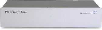

To TNT Audio φιλοξενεί μία...συνοπτική δοκιμή προσιτών προενισχυτών phono απο τις Graham Slee, Cambridge Audio και Parasound.
Συγκεκριμένα, οι υπό δοκιμή συσκευές είναι:
Graham Slee Fanfare (MSRP $460), Cambridge Audio 640P (MSRP $180) και Parasound Zphono (MSRP $150).
Αναλυτικότερα (αντιγράφω απο TNT):
"The Graham Slee Fanfare is a dedicated Moving Coil RIAA phono stage. Contrary to the more common practice of making switchable MM/MC stages, Graham Slee has always had a very strong opinion against phono stages being built to provide more than one level of gain, and generally have recommended using a step-up transformer to load a MC cartridge into a MM phono stage. The Fanfare is their first forray into a MC stage, but still true to their original philosophy this device only has one gain setting (61.5db), and is not suited to accomodate MM cartridges (more specifically anything with an output greater than 4.4mV).
The Parasound Zphono is an op-amp based unit that is designed to be used with MM and MC cartridges. Significant to note is the commendable 10 year parts and 5 years labour warranty.
The Cambridge Audio 640P is also designed to be used with MM and MC cartridges, and includes a subsonic filter. It features single-ended 'Class A' gain stages and discrete transistors."
Kαι η τελική τους εκτίμηση:
"Although it comes with the best warranty and the lowest price point, I cannot recommend the Parasound unit due to the high level of background noise and relative performance. Especially with the Cambridge Audio being in the same price neighbourhood and performing significantly better.
In terms of sonic performance, I would call it a draw between the Cambridge Audio and the Graham Slee. The Cambridge Audio definitely draws out ahead on a lower noise floor and a much lower price point. The latter may be due to no more than the fact that the Cambridge Audio is produced in China and the Graham Slee in the U.K.. But that does not change the fact that the Cambridge Audio unit tied for best performance and hence delivered by far the best value of the three contenders here. It gets my vote and I am buying one for myself."
