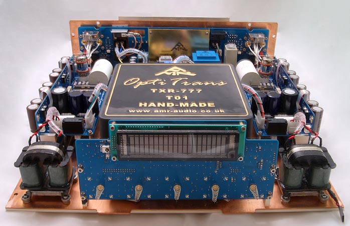

Isn't it embarrassing how the sex word triggers hard-wired reflexes to get our instant attention? Mention integrated amplifiers to the average audiophile male and you'll get a yawn instead of a bulge. Abbingdon Music Research believes they've rediscovered the sex in this category with their new 75 lbs/34kg AM-77. It combines a 5687/6900 NOS valve voltage gain stage with a class A bipolar power buffer. There's patent-pending non NFB error correction. 48,000uF of per-channel capacitance. And a 1200VA custom dual C-core power transformer. These ingredients combine for 180wpc into 8/4 ohms (220/320 watts into 8/2+4 ohms mono strapped). Output impedance is 0.5 ohms and S/N a colossal 100dB or better. The touch-sensitive, auto-illuminating remote shifts volume in 1dB increments over a 71dB range. It also selects from 5 RCA inputs (one is shared with the balanced connectors, one with a 3.5mm iPod link).

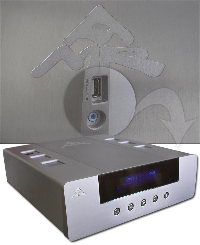

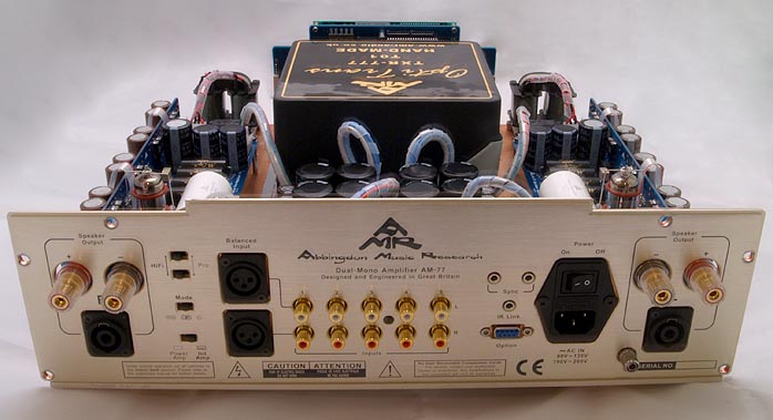

For sexy mating -- who wants mismatches -- there's stereo, mono/mono or high-power mono mode. Unlimited sync'ing with multiple units. Integrated or power amp mode. A provision to adapt the XLR input to transformer-coupled sources. The above-mentioned USB port for an iPod-ish portable source with 5V DC power mounted into the right side edge of the fascia. Paralleled 5-way and SpeakOn speaker outputs. Home theater direct conversion to transform one input into a pass-thru bypassing the volume control. Input labeling from a stored list. Input level offsets for volume matching. Display brightness adjustments. Touch-sensitive chassis controls. And a 9-pin RS232 uplink port for future upgrades. Phew, quite the run-on gymnastics on the interface front.

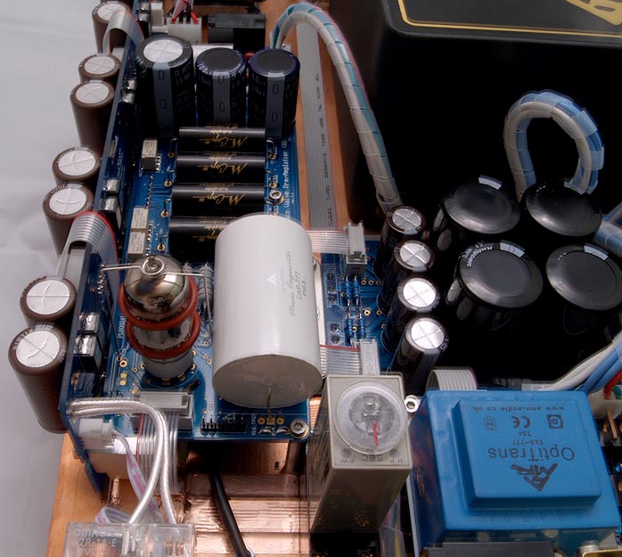

"In the AM-77, two stages are used for the OptiGain®circuit. First, the signal is amplified to the desired voltage using an NOS 5687 electron valve with linearity and drive without the need for a negative feedback loop. This solution is much more costly and difficult when compared with more ubiquitous and cheaper operational amplifiers (op-amps). In our view, this represents a very significant sonic improvement over a circuit with negative feedback.
"The second half of the OptiGain®circuit is the power buffer stage where solid-state technology is combined with a thermionic electron valve phase-separation circuit. The power buffer stage uses AMR's "Class X: Jikoda circuit" with bipolar output devices, which in real-time, simultaneously detects and cancels unwanted artifacts in the audio signal. None pass to effect the playback of music, exceeding the ability of even traditional well-regarded class A circuitry.
