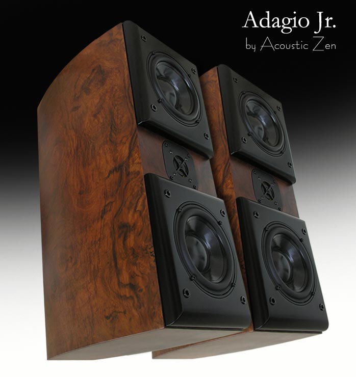

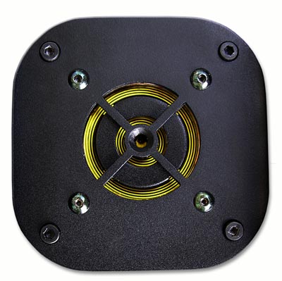

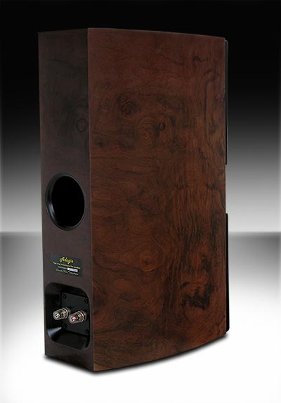

"The Jr. Adagio's cabinet is constructed of 1-inch MDF. Its tapered and curved cheeks are said to reduce internal standing waves and also redirect the rear wave of the drivers to minimize their direct reflections back through the cones. The Jr. Adagio sports a single pair of binding posts and the rest of the accoutrements are said to be identical to the larger and more expensive Adagio: same 6.5 -inch mid/woofers constructed from a fabric layer sandwiched between two skins of ceramic doping; same 1.8" circular ribbon tweeter with a shielded 3.5-oz high-flux, highly temperature-resistant magnet structure. The ribbon's diaphragm is said to be of less mass than the air in front of it, implying it's unusually responsive to the input signal and won't ring as a metal dome nor store energy.
While the ribbon tweeter may be what catches most people's eyes, much of the success of the Jr. Adagio will be owed to the unique and proprietary woofers manufactured in Germany for Acoustic Zen and only Acoustic Zen. Robert Lee didn't invent the underhung motor assembly, with several other notable companies such as Thiel and Wilson Audio
having championed them for years. Yet Acoustic Zen does have their own take on the subject, with drivers of their own design. Basically (no reason for eyes to glaze over on such an important yet simple concept), the voice coil is what propels the driver's diaphragm. It's a wire-wound bobbin at the 'throat' of the cone that moves positively or negatively (back and forth) in reaction to an alternating signal being applied to a magnetic field. Generally, a long voice coil moves through a fairly short magnetic gap. The coil ends routinely move outside the control envelope of the magnetic flux field. This can mean distortion. An underhung motor assembly places a shorter coil inside a longer magnetic field. Regardless of excursion, the coil will never move outside the magnetic gap's control force. The result is said to be less THD, greater transient speed, reduced overall bass distortion and increased detail.
As a two-way speaker, the 3-driver Jr. Adagio utilizes two 6.5-inch mid/woofers with 2.5-inch underhung 7-ounce rare earth Neodymium motor assemblies in a midrange-tweeter-midrange arrangement also referred to as a D'Appolito array. The woofers are mounted to the aforementioned bezels, creating physical time alignment as well as a thicker wave launch foundation due to the combined 1.5-inch stack of enclosure baffle plus added bezel.
Nominal impedance is said to be 6 ohms and sensitivity is 89dB at one watt, one meter - all in all, not that difficult to drive. The crossover hands over to the ribbon tweeter at 3kHz with a 3rd-order 18dB/octave slope. Acoustic Zen rates the Adagio Jr. as having a frequency response of 35Hz -25kHz ±3dB and a power handling of between 50 and 200 watts.
