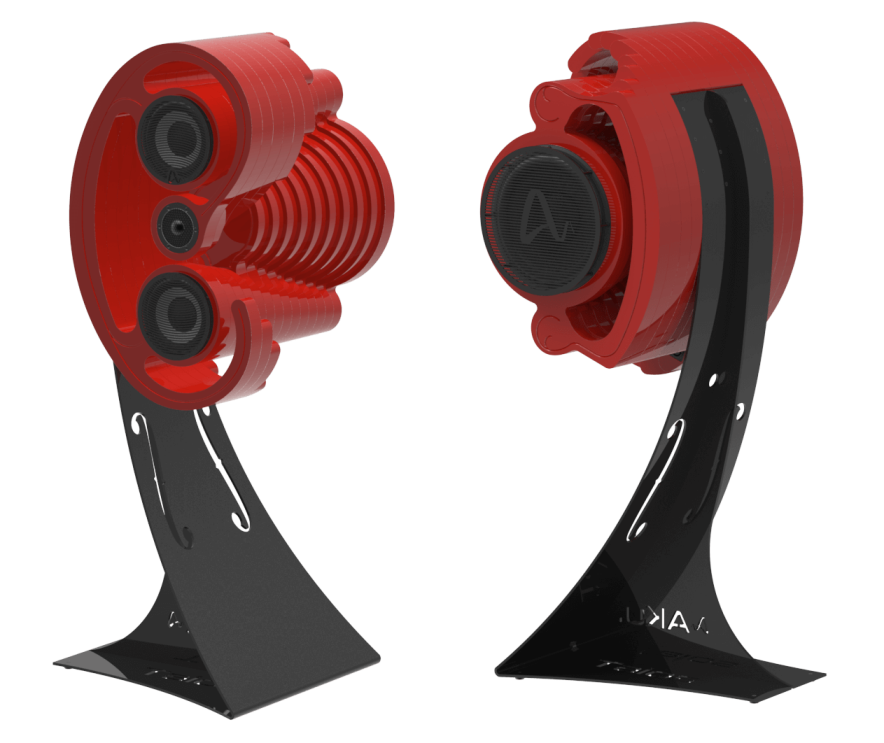

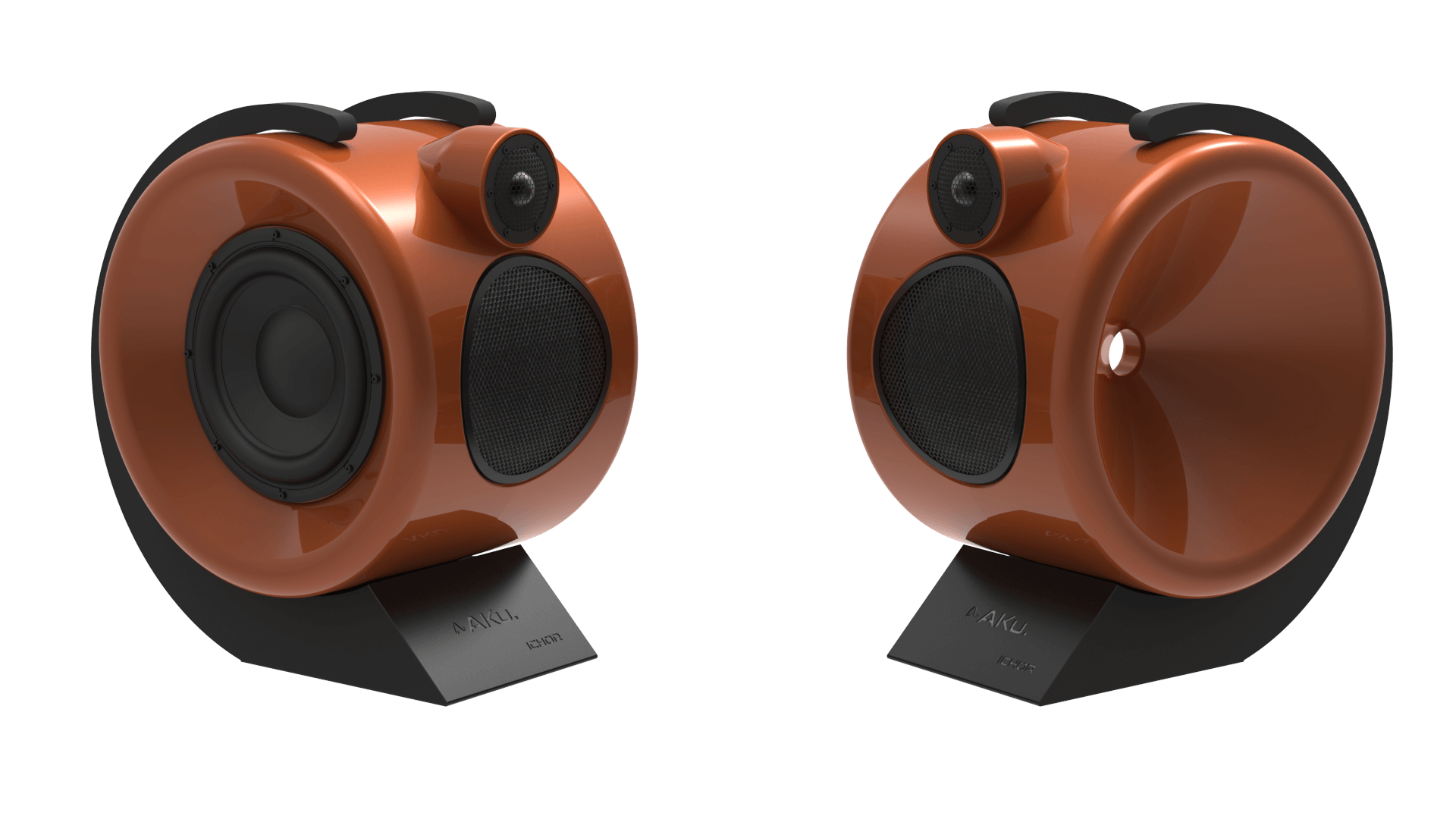

Aku Audio Ichor......active midfield monitor ....MADE IN GREECE
Τρέμετε Kii..s
Technical Specifications
  • null
    System
    – Active 2-way, 2 chamber monitor with cast-aluminum proprietary body construction. Amplitude & time aligned. Ribbed, nonplanar internal surfaces.
    – Minimal Vibration two material design.
  • null
    Driver Composition
    – Mid-Bass section: Ichor boasts one 8″ carbon-paper, high-precision woofer.
    Ichor EB adds two 10” aluminum passive radiators.
    – Treble section: one 1,34″ aluminum-magnesium dome, neo motor high-excursion tweeter with high power handling, low distortion & cross capability.
  • null
    Frequency
    Response
    – Ichor: -29Hz – 25000Hz @ +-2dB
    – Ichor EB: -18Hz – 25000Hz @ +-2dB
  • null
    SPL
    – Ichor: 110dB
    – Ichor EB: 113dB
  • null
    Stand
    – Wooden Stand with Amplifier Compartment Embedded.
    – Felt lining to reduce friction and vibration. Min.+- 20deg. Vertical tilt adjustment.
  • null
    Amplification /DSP
    – One custom AKu-Hypex Ncore 2channel amplifier with DSP plus Digital and Analog I/O
    – Three DSP presets (Maximally Flat, Bass Contour, Party Mode)
    – Mid-Bass: 250Watt
    – Treble: 100Watt
    – Frequency Response: 10Hz-50KHz
    – SNR: 118dB
    – Distortion (THD+N): 0.006% @ half power
    – Global Mains Voltage compatibility (100-240VAC)
    – Efficiency: 92%
    – Max Power Consumption: 350W
    – Power Connector: 3-pin IEC 250Vac, 10A male
    – Neutrik XLR balanced inputs for Analog & AES
    – Hypex Gold RCA unbalanced input for Analog & S/PDIF
    – Optical – Toslink input (up to 96KHz)
    *use of a digital or analog preamp before the amp is advisable.
  • null
    Dimensions
    – Loudspeaker
    H:560mm W:335mm D:510mm
    H:22.04in W:13.18in D:20.07in
  • null
    Weight
    – Ichor: 25kg / 55,10lb each
    – Ichor EB: 27kg / 59,40lb each
