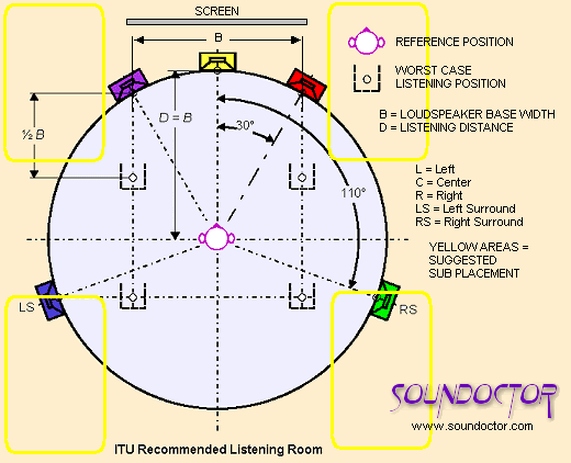

The EARLY DAYS of HOME THEATER - ENTER THX
Once we get past the phenomena of stereo, we arrive at the next historical stop: the suggested THX setup with DIPOLES placed at 90 degrees. The listener is sitting in the null of the out-of-polarity (often somewhat incorrectly stated as 'phase' - they are actually "180 degrees out of phase") surround dipoles, and the dipoles are splaying the Ls Rs outward along the walls of the room. This decorrelated [side] splay gives the listener the sense they are in a large(r) theater.
[/IMG]
Fig (1) - one of the original THX SETUPS
Notice in the above diagram there's NOTHING behind you. (Of course many people place the surrounds "anywhere" because that's the only place they'll 'fit' or 'go'.) Some people put the "surrounds" in the back, or incorrectly stated, in the "rear". This is psychoacoustically and psychologically wrong.
gstriftos
gilectronikos
17.602
4.137
Fig (2) - Typical 5.1 suggested setup.
This is the STANDARD SUGGESTION for "SURROUND SOUND".
This diagram does not presuppose you put speakers in a circle - although that would be best. The supposition is you extend the angular lines outward until they intersect a wall and you put the speakers on that wall. IF front-firing speakers are used, (at the Ls Rs positions) you aim them as shown. If TRIPOLES are used, you place them flat on the wall, so that the correct ratios come out of the [sides of the] box and splay on the walls.

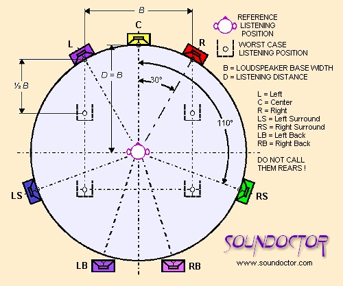

6.1, 7.1 and MORE
FIG (3) - 7.1 Channel setup for the home theater
The angles of the Lb Rb speakers becomes part of a psychoacoustic balance: if you think there's sound that DOESN'T BELONG behind you, it will be frightening. If it properly blends into the scenario of the film and the rest of the acoustic phenomena happening in the room, it will feel "correct". It would seem that firing a speaker right into the back of your head cannot be correct. My suggestion is to make the back pair about half the subtended angle of the front pair, therefore about 30 degrees a part.
