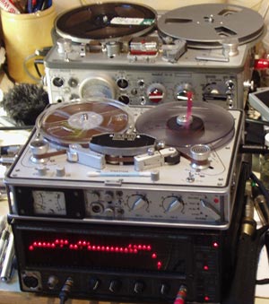

Nagra IV-S TC
Speeds: 3 3/4, 7 1/2, 15 IPS; Reel Size: 7″ and smaller; Format: 1/4″ analog tape. 1/2 track stereo, with centre channel time code (other IV series models for full track mono recording); Operation: Outboard multi-voltage power supply or 12 D batteries

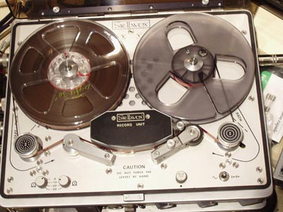

Stellavox SP 8
Speeds: can vary from 1 7/8 to 15 IPS, depending on accessory modules; Reel Size: 5″ or smaller; Format: 1/4″ analog tape, 1/2 track stereo, with various configurations up to wider SM mastering heads (see text) or centre channel time code; Operation: Outboard multi-voltage power supply or 15 AA batteries; uses a system of plug-in potted electronic modules and head blocks for various configurations for different uses

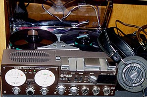

Uher 4200 Report Monitor
Speeds: 15/16, 1 7/8, 3 3/4, 7 1/2 IPS; Reel Size: 5″ or smaller; Format: 1/4″ analog tape, 1/2 track stereo (4400 is 1/4 track stereo, 4000 full track mono); Operation: Outboard multi- voltage power supply, single internal 6-volt battery, or 5 D batteries
