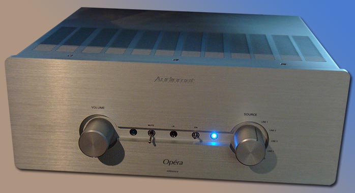

"All of the Opéra Référence's 30 watts run in class A via a quartet of EL34 tubes. The input stage features a trio of NOS 5965s for phase splitting and driver duties. The amp sits on a trio of large nickel-plated brass cones and the chassis is aircraft-grade aluminum with a 10mm thick front panel. Available finishes include brushed aluminum or anodized black.

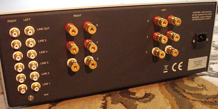

On the front panel there is the motorized ALPS volume control, an input selector for 5 sources and two toggles for power on/off and mute. Two blue LEDs indicate power and mute status. On the back panel there are five pairs of gold-plated line level RCA inputs, one pair of RCA line outs and gold-plated twinned binding posts for 4 and 8 ohm speaker loads and biwiring. A substantial brushed aluminum remote controls volume and mute.

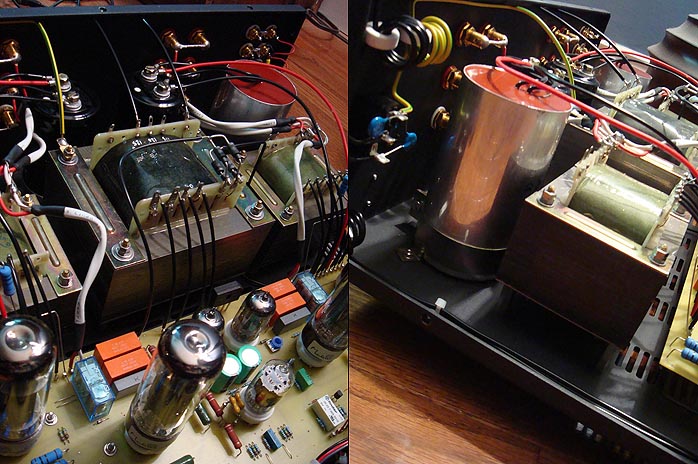

The amp mutes upon power on, the volume knob turns itself down to zero and won't let you crank it up for approximately 30 seconds. Overall build quality is excellent. Internally, I was surprised by the sheer mass of the transformers as well as the pop can-sized storage caps. As the photos indicate, this is one well put together amp.

Ειναι φανερο απο την φωτο οτι απο τις 3 προενισχυτριες, η μια ειναι διαφορετικου τυπου. Και προφανως κοινη και για τα δυο καναλια.
Internally, I was surprised by the sheer mass of the transformers ...
