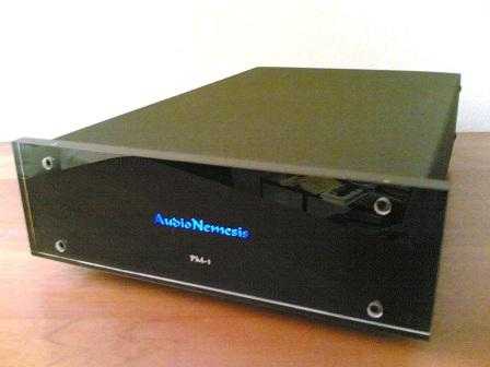

"The unit is presented as a high level, MM (Moving Magnet) cartridge pre-amplifier,

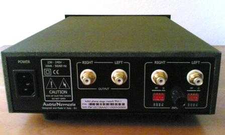

As a matter of fact, the input impedance is configurable, so that it can work perfectly with both MM and MC cartridges.

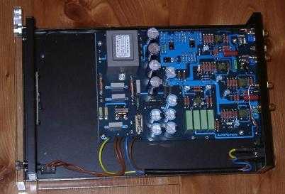

According to AudioNemesis site, it is a discrete components circuit (FET and BJT), with zero feedback, which probably means that there is no feedback loop (which is not exactly the same...). Said this, the solution is definitely valid. Also the choice of keeping the signal path as short as possible is noteworthy, as this helps a lot in keeping picked up electromagnetic disturbs low.
The circuits implements a very precise splitted RIAA, that is the different time constants of the standard curve are implemented in different stages. This helps making the final adjustments easier, and also should produce a better dynamic beahvior.
The power supply is very complex, with several shunt regulators and a specially designed mains filter at the input. Very high quality components are used all over the board. There are also several small HDG graphite blocks which dump vibrations and hide components identification marks....
The layout, by Giuseppe Intorrella, is in general extremely accurate.

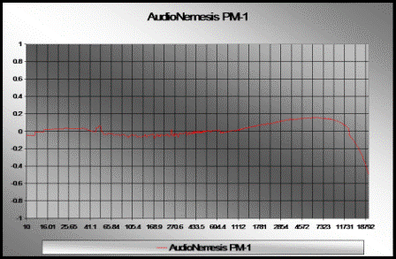

Just to finish with, I measured the matching error between the pre-amplifier frequency response and the RIAA standard curve. It shows that the pre follows the RIAA curve with remarkable precision.
Taking into account the discrete component, zero feedback configuration and the fact that I measurd two different units getting almost perfectly matching diagrams, this is a really outstanding result.
