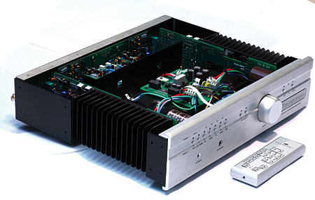

The power-amplifier section of the B100-DA SST ($4395 as reviewed; I didn't specify the phono option) is based on the 2B-SST, Bryston's 100W basic two-channel power amp. It offers dual-mono architecture with two 250VA toroidal transformers; a third, smaller toroidal helps power the B100-DA's digital module. The amp contains over a dozen regulated or stabilized voltage supplies.
Ρemoving the B100-DA's top panel revealed excellent build quality: minimal point-to-point wiring, high-quality resistors and capacitors, and thick, double-sided, glass-epoxy printed-circuit boards with clear markings. The B100-DA's analog preamplifier uses multiple-pole relays to switch sources, and an integrated resistance network is used to control the unit's volume. All analog signal circuits are fully discrete and Bryston uses 0.1% metal-film resistors, polystyrene capacitors, and selects and matches transistors by hand to keep noise and distortion to absolute minimums.
The B100-DA's DAC is described in an article written by one of the company's customers, Jeff Switzer, that appeared in Vol.8 No.3 of the company's online newsletter . A digital signal input through the S/PDIF jacks on the B100-DA's rear panel is fed via impedance-matching transformers to a Cirrus Logic C58420 digital interface chip. This reduces jitter and upsamples the data from 16-bit/44.1kHz to 24/96. As Switzer states, "the upsampling process doesn't add any new data to that which came off the CD but it puts the data in a form which can better be used by the DAC." Another advantage is that a "new clock signal is applied which causes a significant reduction in jitter."
The D/A conversion is handled by a Crystal CS43122 chip. A digital low-pass filter is applied to the signal before its conversion to analog, and an analog filter afterward. The DAC's performance is tightly regulated by a separate filtered analog power supply with carefully routed grounds. The same circuitry can be found in Bryston's SP 2, the five-channel preamplifier and digital processor reviewed by Kalman Rubinson in his "Music in the Round" column in September 2006 (Vol.29 No.9). The only difference is that the B100-DA's DAC reclocks and resamples the digital input.
