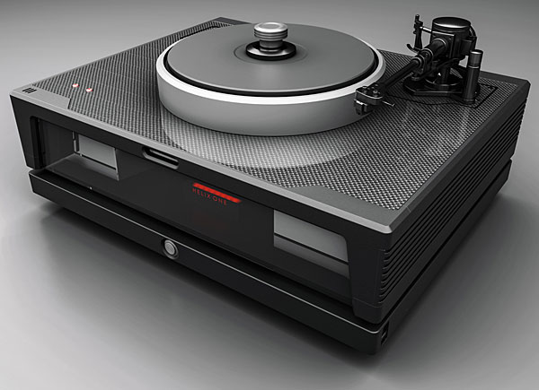

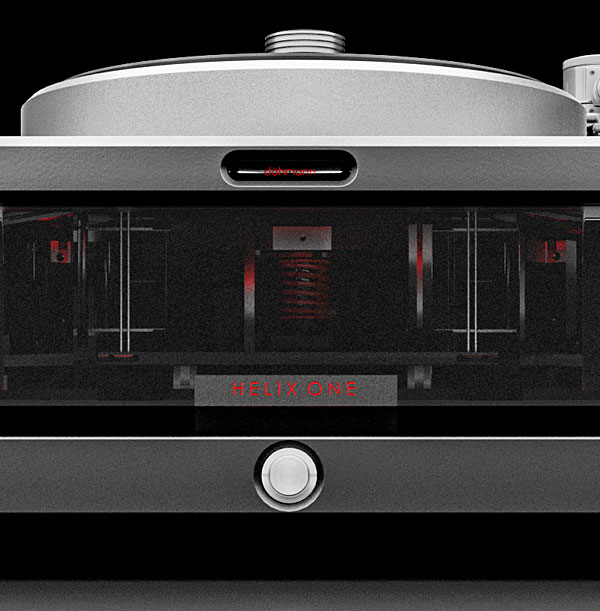

The Mk2 features an internal "mechanical crossover" system that addresses frequencies above 100Hz by providing a smooth mechanical pathway for higher frequency vibrations to travel away from critical areas and dissipate. The motor, platter bearing, and armboard are on separate, interlocking plates (think of leaves on a tree, or think of the bearing as the sun, with the motor and armboards as "planets"), precisely mounted within the turntable in carefully optimized locations away from the center to further isolate the stylus/record interface from unwanted, internally produced vibrations
The motor is an all-new, custom-designed, Swiss-manufactured, high-torque design, controlled by a custom, software-based, closed-loop servo control system located in the PowerBase, which monitors and calibrates speed more than 130,000 times per second. The original Helix One's motor occasionally developed reliability and noise issues. Mr. Döhmann ended up traveling to customers' homes to replace them
Not surprisingly, the Döhmann Helix One Mk2's sound was more similar to the Continuum Caliburn's than it was to the TechDAS Air Force One Premium's; the TechDAS sounded smoother and, you might say, more elegant, refined, and relaxed—probably something to do with the air-bearing platter, though of course that's just speculation.
That's not to say that the Air Force One was overly smooth, or that it softened transients—or that the Helix One Mk2 2 or the Continuum produce harsh transients or overly etched edge definition, or that the latter two were anything but top-to-bottom well-refined, suave, and unflappable sounding. I love how much some people hate far-flung metaphors, so here's one: The Air Force One Premium's sound is an immersion blender soup. The Caliburn's and Helix One Mk2's is more food-processor finely chopped. One is smoother and more velvety while the other is more chunky and textured. Both taste great
As with the Caliburn concept, Döhmann's newer design attempts to isolate the outside world while draining away internal vibrations that can interfere at the stylus/vinyl interface. Consequently, it gets those vibration measurements right.

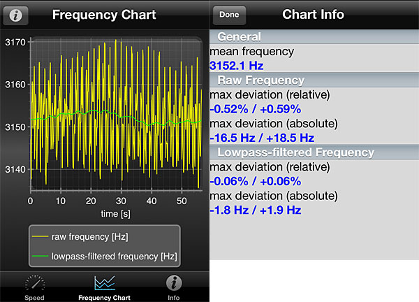

The Mk2 iteration of the Döhmann Helix One turntable produced only one surprise: slightly worse speed measurements; otherwise, the new PowerBase is a useful ergonomic upgrade, while the carbon fiber top looks better. The armboard is improved. User-friendly pushbutton speed control is a big plus, as is the easier setup produced by whatever was done to eliminate the original 'table's need for brass balancing weights.

Speed is constantly calibrated over 130,000 times per second to deliver precise 33.33 or 45.15 rpm (factory default). Default factory set speeds are:
