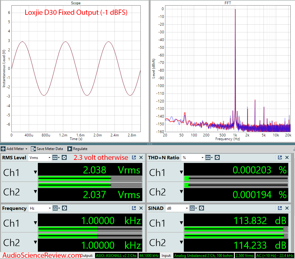

Σε 300Ω ακουστικά, θα παίξει επαρκώς δυνατά ο LOXJIE με 110mW/32Ω?
(και 31 mW/300Ω).
Το συμπερασμα του ριβιουερ:
Headphone Listening Tests
The D30 had no trouble powering my very low sensitivity, low impedance Drop Ether CX. It got loud enough to be very usable with no hint of distortion. Normal listening would be at 80 to 90% volume. Note however that with music recorded at low level, I had to ride the volume to max. Same situation existed with Sennheiser HD-650 headphones. No distortion, loud enough to almost get uncomfortable and excellent fidelity.
Conclusions
The Loxjie targets the most common configuration and features one needs for a desktop product: DAC, headphone amp and bluetooth. The DAC performance is excellent. Anything better would cost you hundreds of dollars more. The headphone amplifier has very good noise and distortion but limited power. And too high a noise floor for sensitive IEMs. Still, as an included amplifier, it does the job for most people.
I debated if I should give the D30 the golfing panther or "I like it" one. At the end, I remembered all the requests I get for a great all-in-one DAC and headphone amp at a reasonable price and this fits the bill most perfectly. To get better, you need to go to a stack of two boxes at a cost of $200. And analog volume control which may cause channel differential.
I am happy to recommend the Loxjie D30.
