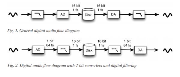

In fig. 1 the general digital audio flow diagram is shown. Assuming the filters fulfill the Nyquist criterium (ie. they pass no signal at frequencies of 0.5 fs or higher) this signal chain is completely indistinguishable from just a noisy low-pass filter.

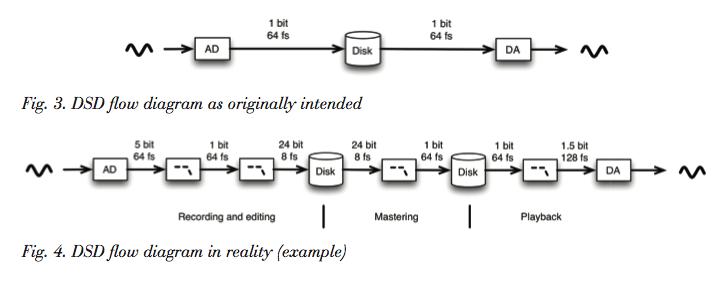

In that same period a discussion had emerged on whether higher sampling rates than 44.1 kHz would sound better, and also on the audible influences of parameter choices in digital filters. Sony Music’s archiving department needed a future-proof format when digitizing their analogue tapes. In 1995 they came to the conclusion that a discussion about what sample rate would be enough could be avoided by simply storing the 1 bit signal directly from the A-to-D. Every conceivable consumer format could subsequently be derived, without loss. Implementation was easy as the Crystal A-to-D chip of the time ran at 1 bit 2.8 Mhz internally and happened to have one ‘test’ pin that carried the 1 bit signal to the outside world. This simple recording/reproduction chain totally avoided the necessity of a decimator in the A-to-D or a modulator in the D-to-A (see fig. 3).
Sony Consumer Electronics soon adopted this new idea as the basis for a successor of the CD. The 1 bit data stream was baptized ‘Direct Stream Digital’. Sony joined forces with Philips to develop the Super Audio CD,
a new 13 cm disc that used DSD for both stereo as well as surround. A few problems submerged though. By the time the SACD reached the market A-to-D chip technology had already evolved to a higher 128 fs sampling speed and had adopted more than one bit (1.5 to 5 for instance) to attain higher quality. To convert this signal to DSD required extra digital processing, which undermined the original 1 bit signal chain simplicity. Philips and Sony were unable to choose a higher quality format as the new optical disc’s capacity didn't allow more than 64 fs data for stereo + surround. But even if it had been possible, then what format to choose as all manufacturers of A-to-D chips had worked out different solutions.

To summarize, already at the introduction of SACD had the DSD promise of an ‘almost analogue, natural data path’ become marketing speak rather than reality. The real data path looked more like the one in fig. 4. Not quite a ‘direct stream’. :prankster:
All this wouldn’t be too serious if it had been without consequences for the sound quality. To go from 1.5 or 5 or 24 bits to 1 bit however is no lossless process, alas. 1 bit modulators are plagued by unavoidable ‘idle-tones’ and vast amounts of noise above the audio band.

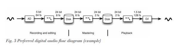

2. Do your recording with any A-to-D converter to your PC in either 2 fs, 4 fs or 8 fs 24 bit format. On the PC do the editing and mixing you need to do. Finally, release the result in ‘native’ 2, 4 or 8 fs 24 bit. :party:
Conversion to 1 bit at 128 or 256 fs is second best. 1 bit 64 fs is third best, still better in bandwidth and noise level than 44.1 kHz 16 bit. And 64 fs will be necessary for SACD, as long as it lasts.

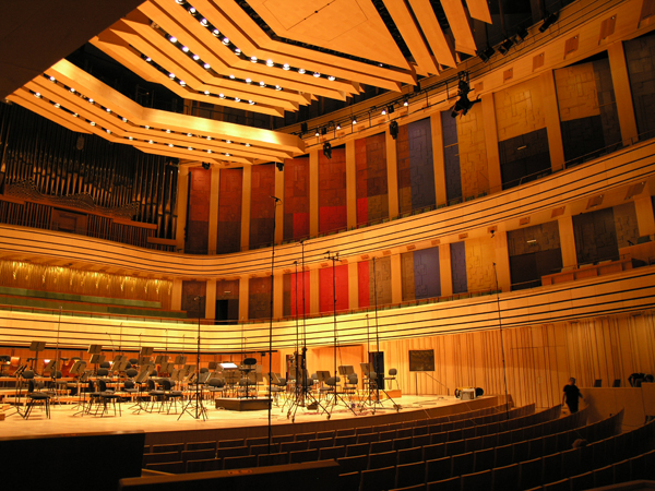

The experts at Native DSD.com are giving you a unique opportunity to compare session files from a brand new performance of “A Midsummer Night’s Dream” by the Budapest Festival Orchestra under the direction of Ivan Fischer. The session was recorded at two different Direct Stream Digital (DSD) bit rates – Single Rate DSD (DSD 64fs) and Quad Rate DSD(DSD 256fs) with two of the industry’s best Analog to Digital Converters – the Grimm Audio AD1 (at DSD 64fs) and the Merging Technologies Horus (at DSD 256fs) Live in Budapest.
