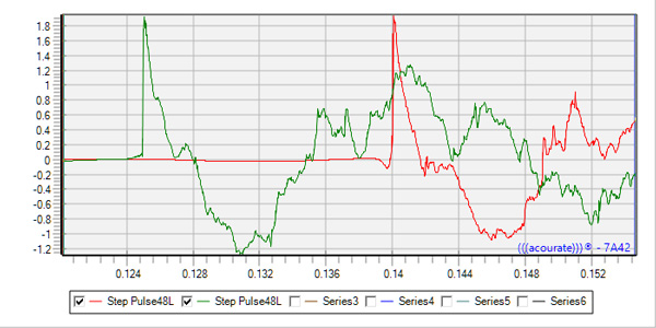

[DOUBLEPOST=1483687989][/DOUBLEPOST]With the right design and cabinet configuration, a multi-driver loudspeaker can approach the coherent sonics of a single point source and deliver a more linear polar pattern than planar loudspeakers like Quad and Magneplanar. The Revels needed considerable excess phase correction, which resulted in an impressive transient response and impact. But out of the box the Dynaudios are already phase-coherent so I did not need apply any phase correction for the main loudspeaker and just a bit of it to improve the performance of the JL subwoofers. With or without correction, the Dynaudios have the most impressive and accurate transient response I’ve heard from any speaker in my entire career! Here is a graph comparing the corrected step responses of the two loudspeakers.
image: http://www.innerfidelity.com/images/KatzCorner_Ep11_Graph_Impulse.jpg
12B Step Response, after excess phase correction. Green: Revels & JL woofers. Red: Dynaudios & JL woofers.
In both traces we can see a distinct single positive-going impulse followed by the recovery back to 0 volts. Even though the Dynaudio contains four woofers, two midranges and two tweeters! A remarkable achievement. It took a lot of correction to get there with the Revels and to my ears the sound is not as coherent or tight as the Dyns.
