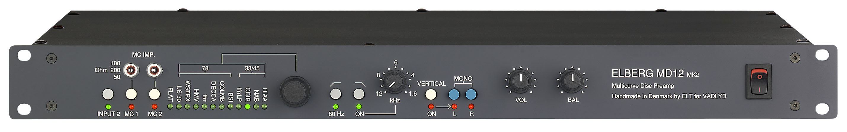

ELBERG MD12 MK2
Price for the MD12 MK2 1150,- €
This custom-built preamp is a product with professional specifications. But the preamp is useful for record collectors, who want the right equalization of especially their 78 RPM records:
ELBERG MD12 MK2 has 12 “presets”, but it is possible to tweak it to nearly all existing eq curves.
For audio professionals and LP collectors, the preamp will be interesting because of its fine sound quality, and 4 eq settings for 33/45 RPM, and 8 pre settings for 78 RPM.
It has selectors for: Stereo, Mono, Mono playing of right or left channel (groove wall) and switch for playing vertically cut records (Pathι/Edison).
The preamp is equipped with volume- and a stereo balance potentiometer. This means that the preamp is able to drive a power amplifier directly.
It is build with a lot of LEDs for easy operation.
The stereo output is AES balanced with gold plated Neutrik XLRs. As an option, we can deliver cables for connecting to consumer equipment.
ELBERG MD 12 MK2 is mounted in a one unit 19” metal rack box.
Input impedance for MM cartridge is standard 47 kOhm.
MC inputs are with 3 switchable load impedances: 50, 100, or 200 Ohm.
