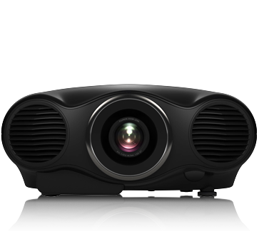

Η EPSON ταυτόχρονα με την παρουσίαση του EPSON LS10000 παρουσίασε και ένα μικρότερο μοντέλο με την ονομασία EPSON LS9600.
Ο νέος αυτός προβολέας θα έχει την νέα πηγή φωτός (Laser) αλλά με ανάλυση 2Κ.
Επιπλέον θα ενσωματώνει ασύρματη μετάδοση.
Specifications
Projection System:
3LCD Reflective 3-chip technology
Projection Method: Front / rear / ceiling mount
Product Color: Black
Driving Method: Epson Poly-silicon TFT Active Matrix, 0.74-inch wide panel Reflective HTPS
Projected Output: HD, 2D, 3D, 1080p
Pixel Number: 2,073,600 dots (1920 x 1080) x 3
Color Brightness (Color Light Ouput): 1300 lumens1
White Brightness (White Light Output): 1300 lumens1
Aspect Ratio: 16:9 widescreen (4:3 resize) Compatible with 4:3 and 2.35:1 video formats with Normal, Full or Zoom Modes
Native Resolution: 1080p (1920 x 1080)
Resize: 16:10, 4:3
Laser Type: Laser Diode 33.7 mW (Output)
Light Source Life: Up to 30,000 hours (ECO Mode)2
Throw Ratio Range: 1.28 (Zoom: Wide), 2.73 (Zoom: Tele)
Size (projected distance): 100″ diagonal (wide: 9.3′ – tele: 19.8′)
Keystone Correction: ±30 degrees
Contrast Ratio: Absolute Black (Full White 1300 lumens / Full Black 0 lumens)
Color Reproduction: Up to 1.07 billion colors
Color Processing: 10 bit (Partial 12 bit)
Projection Lens
Type: Powered Optical zoom/ Powered focus
F-number: 2.5 – 3.7
Focal Length: 21.3 mm – 44.7 mm
Zoom Ratio: 1.0 – 2.1
Lens Shift:
Vertical: 90% max (up and down with horz. centered)
Horizontal: 40% max (left and right with vertical centered)
Lens Cover: Powered, Slide Lens Shutter
