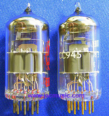

Another difference is in the part numbering. E88CC originally is a long life version with gold plated leads, but the TESLA version has only normal leads. In the below picture you can see this difference clearly.
Gold pin TESLA tubes.

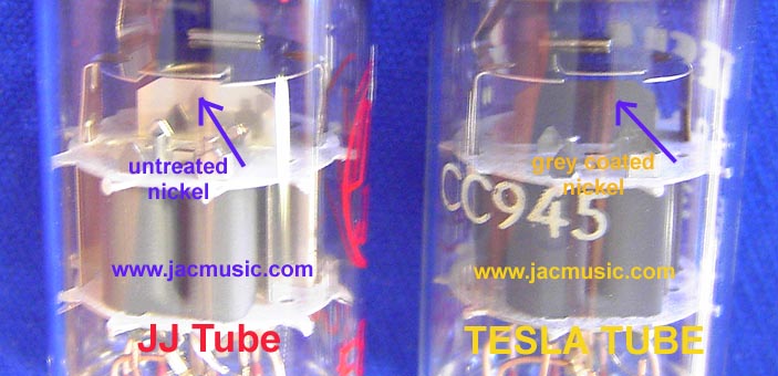

The next differnce I noted, are some costs savings on the shielding. With this tube there is a shielding plate between the two triodes. With the TESLA tube, they did someting nice. The shielding plate was coated black, and is used to transport the heat out of the tube center. So is is used a cooling fin. This is great, because the center anode plate is already hotter than the outside anode plate.
Grey coated shield by TESLA
With the JJ tubes, exactly the same shielding plate is used as with the TESLA tube. Only JJ uses lower cost, untreated white nickel, so the cooling fin function is not present any more. This will give the old TESLA tubes a better lifetime expectation. In vacuum, only black material will radiate heat very good.
For the Czech Post, a GOLD GRID version was made. These are little jewels. Highly underestimated. Most of them have yellow printing. These are from the 1960's.
Here you see a close up of the gold plated grid bars coming out of the mica. So obviously they did not use just gold plated grid wire, they gold plated the complete grid after it was made. What a quality this is!
