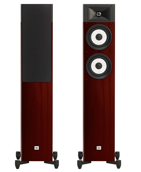

BL says the Stage A170 is "a 2.5-way design": The top woofer operates as a mid-woofer in a traditional two-way loudspeaker and crosses over to the tweeter at 2.8kHz; the bottom woofer is rolled off sooner, at 1.8kHz. The main intention of this strategy is to broaden the A170's dispersion in the tweeter/mid crossover region, while adding cone-area and piston-power to the midrange and bass regions
The Stage A170's high-frequency driver uses a 1" aluminum dome in something JBL calls a "high-definition imaging waveguide." I translate that to mean: The tweeter's dispersion is controlled on both the vertical and horizontal axis. You can translate that to mean the A170s are engineered to image well

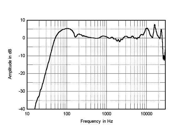

JBL Stage A170, anechoic response on tweeter axis at 50", averaged across 30° horizontal window and corrected for microphone response, with the complex sum of the nearfield woofer and port responses plotted below 300Hz
To sum up, JBL's Stage A170 offers excellent measured performance, especially considering its affordable price.—John Atkinson
Description: 2.5-way, floorstanding, reflex-loaded loudspeaker. Drive-units: 1" aluminum-dome tweeter, two 5.25" polycellulose-cone midwoofers. Crossover frequencies: 1.8kHz, 2.8kHz. Frequency range: 44Hz–40kHz. Sensitivity: 89dB/2.83V/m. Nominal impedance: 6 ohms. Recommended amplifier power: 20–200W.
Dimensions: 7.5" (190mm) W by 36.7" (930mm) H by 10" (255mm) D. Weight: 31.6lb (14.3kg).
Finish: Pantone black or two-tone wood.

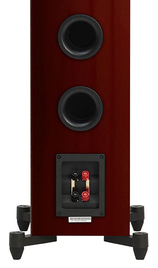

Enclosure TypeBass-Reflex via Rear-Firing Tuned Port
