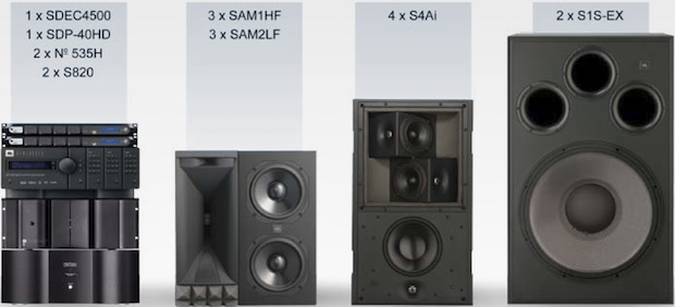

Harman Unveils the Synthesis One ML Premier Home Theater System Home Theater News Speaker Systems News Written by Dick Ward Monday, 09 August 2010
Just the words "home theater system" can be an instant turn off. They can put you in mind of those $500 boxes that contain a few cheap speakers and a DVD player with an integrated amplifier. It's the sort of phrase that dredges up images of Best Buy and Walmart.
Harman's home theater system is more than a little different. It comes with the THX Ultra2 certified SDP-40HD surround processor, a pair of No. 535H multichannel amplifiers, two S820 stereo/mono amplifiers and the SDEC4500 digital equalizer/crossover.
It comes with some pretty impressive hardware in the speaker department too. You'll get three SAM1HF high-frequency horn modules, three SAM1LF low-frequency horn modules and four S4Ai MultiPolar in-wall surrounds. You'll also get a pair of S1S-EX passive subwoofers, each boasting an 18 inch cone.
The system consists of products from both JBL Synthesis and Mark Levinson and runs $88,100. CommentsAdd New |Search

Αυτα τα σαμπ(4 τεμαχια) δεινει και για το δικο μου με τους τελικους(4 τεμαχια) της jbl γεφυρωμενους μονομπλοκ(ς 820) 800w εκαστος.Μηπως θα επρεπε να ριξω ενα τετοιο (τεμ)και να τελειωσω μια για παντα με τις χαμηλες μου?(ρωταω αυτους που ξερουν τον χωρο μου και το συστημα μου).Δεν εχουν και καποιο φοβερο κοστος.Επισεις αυτα τα περιφεριακα δεινει για ολα πλεον τα συνθεσις,ειναι διπολα? τι ειναι?
