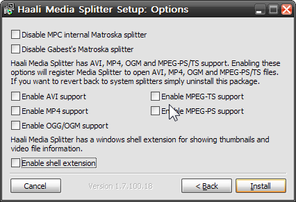

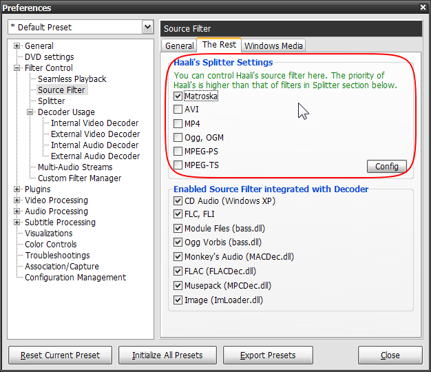

If you want to use haali's splitter without problems, follow the steps. (As I said, it is not a required procedure as KMP has its own splitters. It is for those who are not satisfied with KMP's splitter.)
1. Uncheck all items while installing haali's splitter. It will make the priority of haali's splitter lower. (1st screenshot)
2. Enable the items to be supported from haali's splitter. (2nd screenshot)
ps. If you have haali's splitter in your system, uninstall it first.
