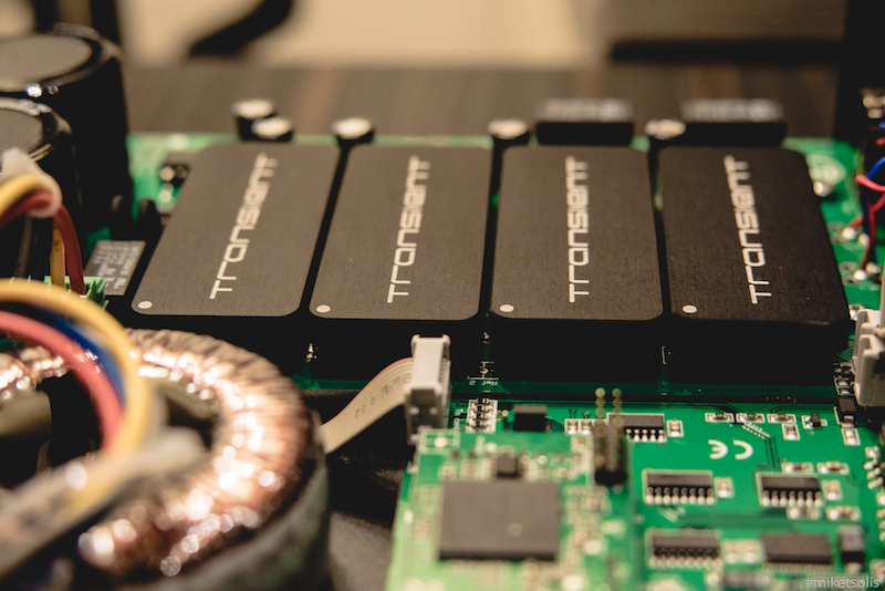

The Menuet is using four Transient™ R2R ladder modules as used in the Pavane. These modules can handle extreme high sampling rates but are limited to current industry standards which has its maximum (384kHz) on the USB input. Like the Pavane digital data will be split over two 12 bit clusters. Each dac cluster processes a portion of the data in the most linear region of the dac chips and as a result a full 24 bits range in the analog domain will be realized. Despite the single board design, channel separation is close to a dual mono operation. This contributes to the flawless positioning of instruments. The result of this process is an extremely fast and accurate behavior and brings listening experience on a higher level .
