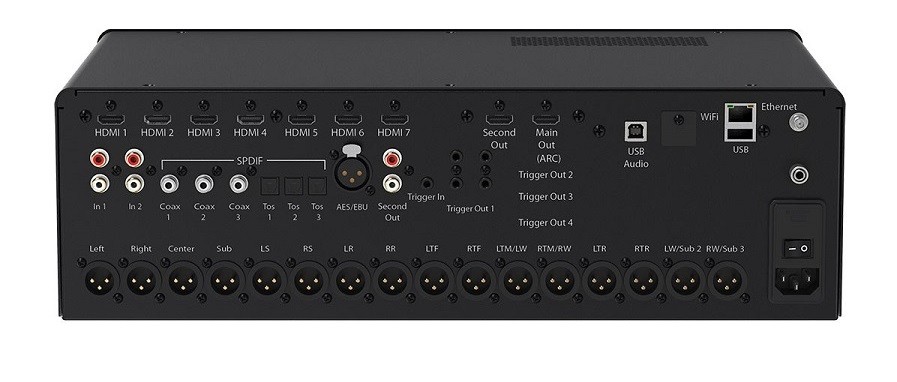

Video Inputs
HDMI 2.0b with HDCP 2.2 HDR10, HDR10+, Dolby Vision (upgradable to HDMI 2.1 in the future) x7
Video Outputs
HDMI 2.0b with HDCP 2.2 with HDMI eARC
Audio Inputs
Toslink x3
Coaxial x3
AES/EBU
USB Audio (24bit/192khz)
2 Stereo Pairs RCA
Other Inputs
Trigger in
USB Service Port
Ethernet
Alexa Compatibility (Requires Echo or other Amazon Device)
Audio Outputs
16 Balanced XLR Connectors (primary)
1 Pair Stereo RCA Unbalanced (stereo mixdown)
Other Outputs
Trigger Out x4

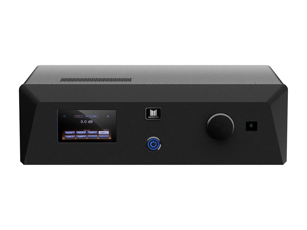

Chassis
Size: 17.1”W x 5.7” H x 12” D
Front panel touch screen 4.3 inch diagonal, RGB 480 × 272
