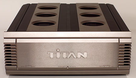

  • Description: Solid-state, two-channel, fully balanced power amplifier with standalone power supply.
  • Maximum power output: 1kWpc into 8 ohms (30dBW), 2kWpc into 4 ohms (30dBW), "just short of" 4kWpc into 2 ohms (30dBW).
  • THD+noise:<0.008%, 20Hz–20kHz. Signal/noise:>126dB, A-weighted (no reference level quoted).
  • Intermodulation distortion: not specified.
  • Maximum output voltage: 90V RMS, 20Hz–20kHz; 254 peak–peak.
  • Peak output current: limited to 100A peak–peak.
  • Frequency response: 20Hz–40kHz,–0.5dB.
  • Input impedance: 100k ohms (balanced, unbalanced).
  • Input sensitivity for full power out into 8 ohms: 3V.
  • Damping factor: 250.
  • Dimensions: Amplifier: 19" (483mm) W by 7.3" (185mm) H by 25" (635mm) D. Weight: 99 lbs (45kg). Power supply: 19" (483mm) W by 7.3" (185mm) H by 24.5" (615mm) D. Weight: 150 lbs (68kg).
  • Price: $30,000. Approximate number of dealers: 70. Warranty: 5 years parts & labor.

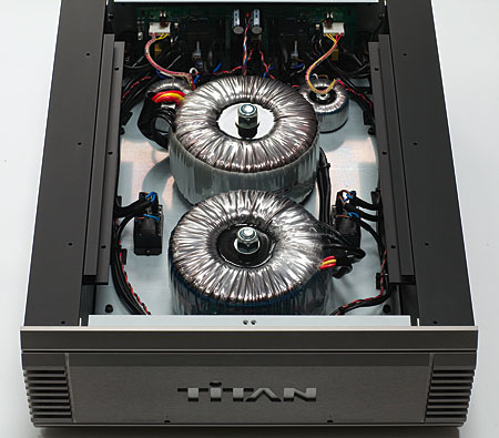

Tα μετασχηματιστάκια που βλέπετε στο σασί της τροφοδοσίας είναι 3kV το καθένα...
