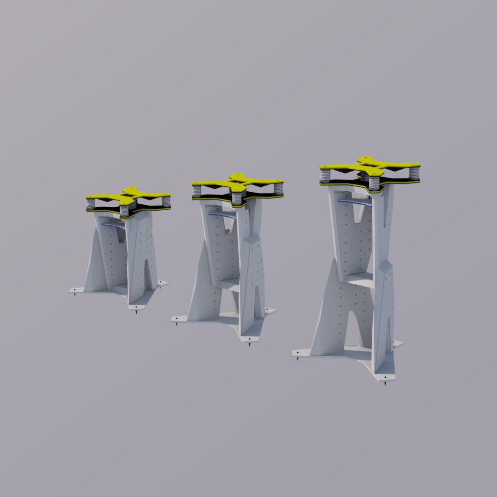

Το κορυφαίο μαγαζί ακουστικής άρχισε να πουλάει έπιπλα στέρεο και βάσεις ηχείων. Και τί βάσεις! Διαβάστε και κλάψτε:
Designed for larger midfield free standing loudspeaker setups, the Speaker Stands Type 400/60.100 use a custom designed high pressure pre-constrained and tunable “push-pull” decoupling system based around industrial grade, low natural frequency springs for Low Frequency decoupling and a SYLODYN® constrained layer damping interface for Mid and High Frequencies decoupling and plate damping.
With a decoupling system achieving natural frequencies as low as 4.5Hz, these stands are simply unique on the market. Your loudspeakers perform at their best by completely removing mechanical transmission of vibrations through the stands to the floor and surrounding structure and furniture. Distortion levels due to structural re-emissions are reduced in the room, clarity and depth of field over the whole spectrum enhanced.
Height can be adjusted in 50mm (2″) increments.
www.northward-systems.com
- Minimum admissible load: 60kg
- Maximum admissible load: 100kg
- Natural frequency at minimum load: <7Hz
- Natural frequency at maximum load: <5Hz
- Minimum height: 658mm (25.9") +/-15mm spikes adjustment
- Maximum height 1060mm (41.7") +/-15mm spikes adjustment
- Plate dimensions: 370/430mm
- Class AAA high resistance satin painted MDF structure
- High quality powder coated 306 grade INOX steel base, plates and local reinforcements
- Mechanically and acoustically non-resonant structure
- Top, central steel plates and push-pull plates constrained layer damping using 6mm SYLODYN® layer
