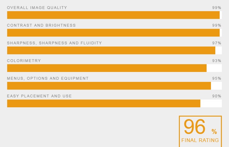

'' That combination along with the top tier image quality--high contrast, eye catching color, and three-dimensionality--makes the Optoma UHZ65 a bargain at $4,499''Κ.Κ...αρχίζει σιγά σιγά η δικαίωσή σου για τους uhd dlp:D:p
:roflmao::roflmao:
Most important, the UHZ65 delivers images notable for their high contrast, saturated color, and sense of three dimensionality.

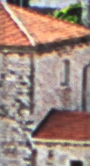

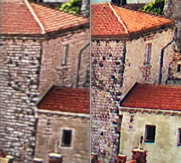

....κοντα το dlp e-shift σε 4κ σε σχεση με τα hd e-shift των LCD-LCOS :p:D
DLP e-shift vs. native 4K
2716x1528 vs 4096 x2160
LCOS e-shift
1920x1080
