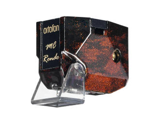

Μία νέα σειρά από προσιτές κεφαλές MC παρουσίασε η Ortofon. Η σειρά Rondo περιλαμβάνει 3 κεφαλές την Blue, την Red και την Bronze.
TECHNICAL DATA MC RONDO BRONZE
Output voltage at 1000 Hz, 5cm/sec. 500 µV
Channel balance at 1 kHz 1 dB
Channel separation at 1 kHz 25 dB
Channel separation at 15 kHz 18 dB
Frequency range 20-40.000 Hz
Frequency response 20-20.000 Hz ±1,5 dB
FIM distortion at recommended tracking force, DIN 45.542 < 1%
Tracking ability at 315Hz at recommended tracking force 90 µm
Compliance, dynamic, lateral 15 µm/mN
Stylus type Nude FG80, tapered Al. cantilever
Stylus tip radius r/R 5/80 µm
Equivalent stylus tip mass 0,30 mg
Tracking force range 2-2,5 g (20-25 mN)
Tracking force, recommended 2,3 g (23 mN)
Tracking angle 20°
Internal impedance, DC resistance 6 Ohm
Recommended load impedance 10-200 Ohm
Cartridge body material Grinded wood/Resin comp.
Cartridge colour Bronze
Cartridge weight 10,5 g
TECHNICAL DATA MC RONDO BLUE
Channel balance at 1 kHz 1,5 dB
Frequency range 20-35.000 Hz
Tracking ability at 315Hz at recommended tracking force 85 µm
Stylus type Nude FG70, Al. cantilever
Stylus tip radius r/R 5/70 µm
Tracking angle 20°
Cartridge body material Grinded wood/Resin com.
Cartridge colour Blue
TECHNICAL DATA MC RONDO RED
Channel balance at 1 kHz 2 dB
Channel separation at 1 kHz 22 dB
Channel separation at 15 kHz 15 dB
Frequency range 20-30.000 Hz
Frequency response 20-20.000 Hz ±2 dB
Tracking ability at 315Hz at recommended tracking force 80 µm
Stylus type Nude elliptical Al. cantilever
Stylus tip radius r/R 8/18 µm
Tracking angle 20°
Cartridge colour Red
