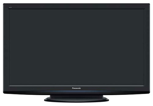

Μια 50άρα απ την οικονομική σειρά της Panasonic.
Conclusion
The Panasonic TX-P50S20B is an excellent Plasma HDTV which produces performance far beyond that of most budget displays. The only measurable inaccuracy is with its Gamma tracking, which means that material viewed on the TV will look very subtly brighter (at points) to the way the producers intended. However, out of all the potential inaccuracies a video display could have, this is probably the most subtle one possible and is really not worth worrying about for 99% of users. Also, consistent with other Panasonic displays, the TX-P50S20B has no film cadence detection at all, which means that film material (except when input from an upscaling DVD or BD player) will suffer from a slight loss of vertical resolution.
Other than these minor issues, it’s a truckload of good news for this cost-conscious HD TV: excellent blacks, crisp motion clarity, perfect screen uniformity, fantastic colour accuracy, excellent greyscale tracking, and no input lag worth worrying about. Panasonic’s budget S20 series of Plasma displays is an excellent alternative to the cascade of lower-quality LCDs in this price range, and is a reminder that high quality Plasma performance is available to suit all budgets — not just to videophiles with deep pockets.
