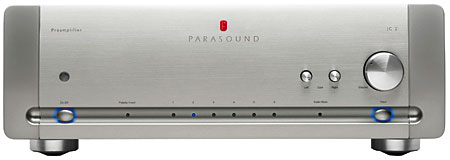

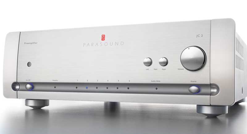

Parasound is now shipping the JC 2 stereo preamplifier in its high-end Halo product family. The Parasound Halo JC 2 was designed and engineered by the legendary John Curl and CTC Builders team who have been responsible for some of the most highly regarded audio components of the past 25 years, including the acclaimed Parasound Halo JC 1 400-watt mono power amplifier.
The Parasound Halo JC 2 is a precision analog stereo preamplifier that audiophiles will use to switch between audio source components and to control the output level of the connected power amplifier. While this role may seem relatively simple, many designers and engineers have devoted lifetimes to getting it right.
According to Parasound's president, Richard Schram, "We conceived the Halo JC 2 in the spirit of the JC 1, commissioning John Curl to design a two-channel preamplifier without compromise. The resulting product achieves a higher level of sonic and measured performance than any preamplifier since Parasound was founded in 1981. The sound of the Halo JC 2 is alive with musical detail against a silent background that will give serious audiophiles both the opportunity and desire to re-explore their music collections."
The Parasound Halo JC 2 reflects Curl's genius for circuit design and performance, expressed through Parasound's obsession with quality, functionality and value. The JC 2 employs fully-balanced inputs and outputs with professional-grade XLR audio interconnections for the lowest possible levels of noise and distortion. It also has standard un-balanced connections, plus exceptional facilities for interfacing with integrated home control, remote control and other modern integration technologies.
The Halo JC 2 has a total of six line-level inputs, with two of those switchable for balanced or unbalanced connections. The main output jacks have both balanced XLR connectors and unbalanced RCA connectors. When used with power amplifiers that invert polarity the user can maintain absolute polarity, either by using the rear-panel inverted output jacks or by using the main output jacks and the polarity invert button on the included IR remote control. There are also fixed-level RCA record output jacks for connecting audio recording devices.
The infrared remote control has buttons for on/off, DC trigger activation, polarity normal/invert, volume, mute, and source selection. There are also tuning buttons for the Parasound Halo T 3 FM/AM tuner. Custom installers and systems integrators will appreciate the inclusion of an RS-232 interface, four 12-Volt Triggers, and remote control repeater input and loop out jacks. The RS-232 interface allows bi-direction communications with home automation and control systems such as Crestron, AMX, Control4, Niles, and Elan.
The Parasound Halo JC 2 is now available from select Parasound dealers. It has a suggested retail price of $4,000.

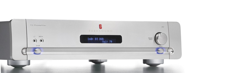

Άλλο ένα ενδιαφέρον μηχανάκι είναι και αυτό :
Αναλογικός προενισχυτής 7 καναλιών .
Συνδέεις την δικάναλη πηγή και το φοβερό νέο player υψηλής ευκρίνειας από τις αναλογικές του εξόδους και τέλος.

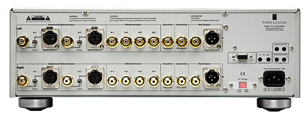

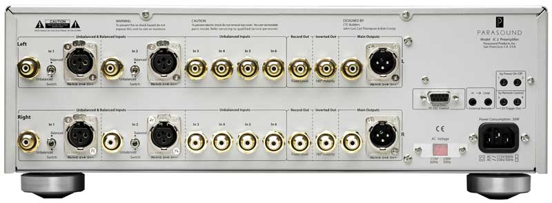

The rear panel is dominated by the two rows of input and output jacks, one row for each channel. There are six pairs of unbalanced inputs, two of which can be switched to balanced mode. As well as a pair of fixed-level Record Out RCAs, there are inverting and non-inverting main unbalanced outputs on RCAs and a pair of balanced outputs on XLRs, these wired with pin 2 hot. The gold-plated RCA jacks are all sourced from Vampire, the XLRs from Neutrik.

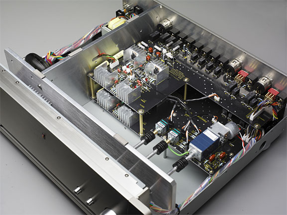

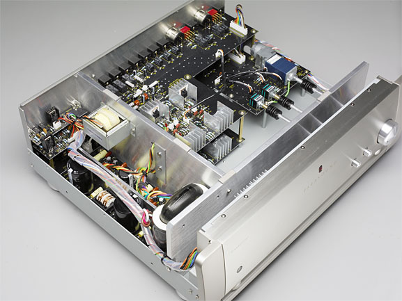

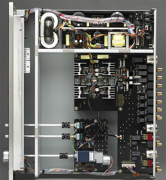

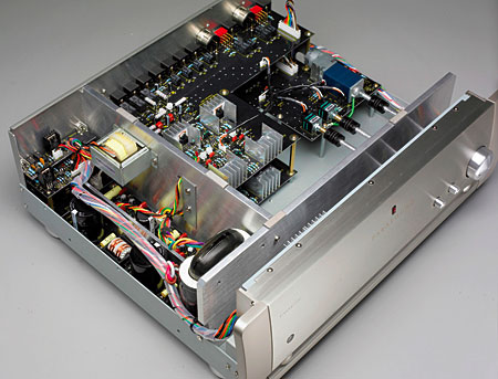

Internally, vertical 3/8"-thick aluminum panels separate the chassis into three shielded regions. On the left is the inductor-smoothed power supply, based on an R-core transformer and fast, soft-recovery bridge rectifiers and diodes. There is a separate supply for the relay coils, triggers, LEDs, and control circuitry, this carried on a vertical board behind the front panel.
The audio circuitry, shielded from the power supply and control sections, is carried on a separate board for each channel, and is based on hand-matched complementary FETs, a feature of John Curl's designs for a quarter-century now. The circuit is direct-coupled, with no capacitors in the signal path, and with DC offset controlled by a servo circuit. Following the short signal path, the input jacks feed a relay driven by the input-select switch. A four-gang, motor-driven potentiometer adjusts volume and polarity inversion of the output signal is performed with gold-on-silver–contact relays.
