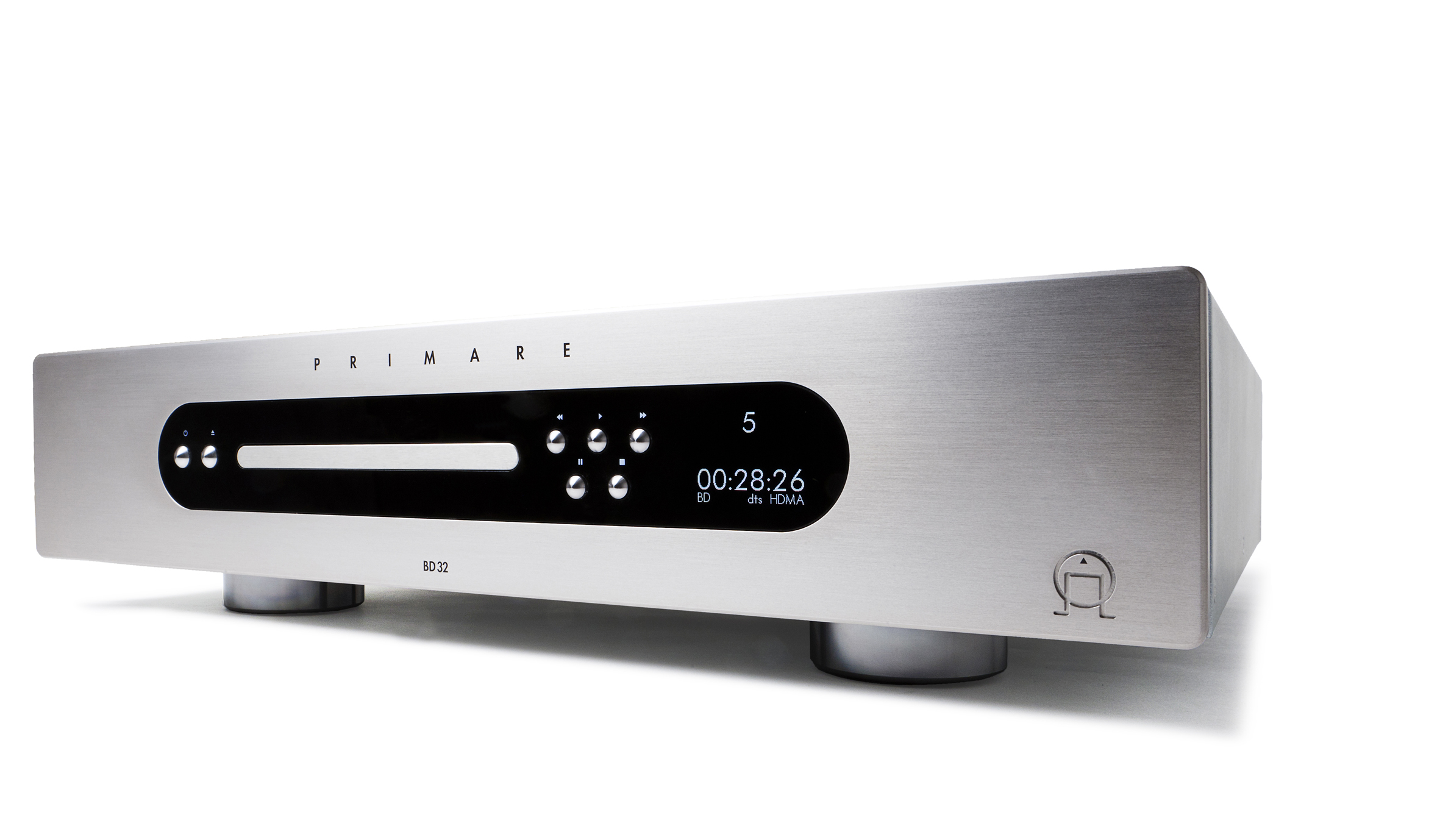

Primare BD-32.
gstriftos
gilectronikos
17.751
4.458
High performance multi-format/multi-channel player
Blu-ray, DVD, CD, SACD, DVD-A and media
Dual simultaneous HDMI 1.4a outputs (3D)
Proprietary Primare audio stage
Multiple custom-engineered power supplies
OLED user interface
CD performance: Freq resp -0.19dB @20k; THD+N 1k 0dBFS (22k LPF) 0.0015%; Noise A-weighted. -138dBV
SACD (DSD) performance: Freq resp -0,17dB @20k; THD+N 1k 0dBFS (22k LPF) 0.0055%; Noise A-weighted. -125dBV
Analogue outputs: 1 pair Stereo XLR and 1 pair RCA both 4,3Vrms
1 multichannel 7.1 RCA input
Digital outputs: 1x SPDIF (RCA); 1x AES/EBU (XLR); 1x optical (TOS-link)
Inputs: USB, LAN, e-Sata, IR in/out 3.5mm; RS232; Trigger in/out 3.5mm
D/A converter: Crystal DSD DAC CS4398
Output impedance: RCA 100Ohm; XLR 110Ohm
Power consumption: Standby 0.5W, Idle 50W, Operation 60W
Dimensions: 430 x 375 x 106 mm
Weight: 8.5kg
Colour options: Black or Titanium
http://www.primare.net/product.asp?ProductID=52&d=2
coming soon..
