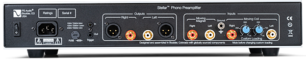

From the handset you can turn the Stellar Phono on and off, select MM or MC inputs—there's one pair of each—toggle through various gain settings (44dB, 50dB, and 56dB for MM cartridges, 60dB, 66dB, and 72dB for MC), and select between buttons for four preset loads—60 ohms, 100 ohms, 200 ohms, or 47k ohms—or a button that enables the above- mentioned custom-setting knobs, which range from 1 ohm to 1k ohms.

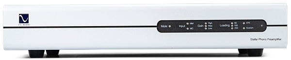

There's also a Mute button that, when pressed, illuminates a red LED on the left side of the Stellar's front panel; the rest of the indicator lights are blue. The identifying labels next to the latter aren't illuminated, and the bright LEDs overwhelm the text, but it doesn't really matter because those LEDs are logically grouped, their meanings easy to remember

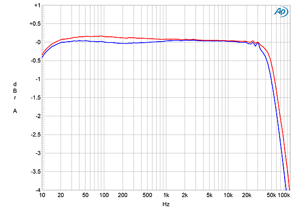

MM input, Low gain, response with RIAA correction into 100k ohms (left channel blue, right red) (0.5dB/vertical div.).

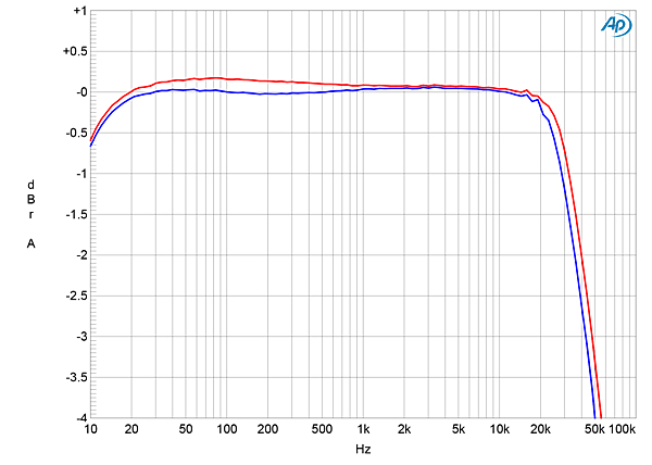

MC input, Low gain, response with RIAA correction into 100k ohms (left channel blue, right red) (0.5dB/vertical div.).
