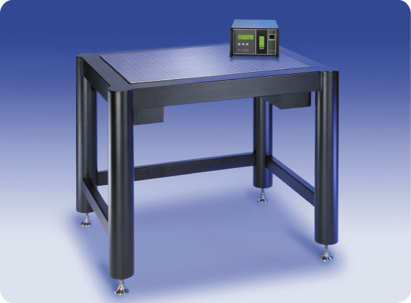

Fully automated auto-leveling
AC power from an electrical outlet is sufficient; no compressed air supply is needed
Provides better vibration isolation (> 98.22% isolation above 10 Hz) than is normally possible with complicated, large optical tables
No natural low-frequency resonance; as a result, excellent vibration characteristics also in frequency ranges below 5 Hz
Active isolation in all six degrees of freedom
USB 1.1 port and evaluation software for Microsoft Windows PCs
The performance of every vibration isolation system is affected by the basic conditions in the particular laboratory. Under the most favourable conditions, the vibration isolation system is located directly on the floor. As this is not feasible in most cases, tables or support frames are needed, which in turn have to meet high requirements. For its workstation systems, Halcyonics basically uses welded support frames that are ideal for use with active vibration isolation systems. Halcyonics workstations consist of a combination of the active vibration isolation system, stainless steel breadboard and a support frame perfectly matched to this system.
High-performance workstation solution – three standard sizes available
In addition to their high isolation from floor vibration through AVI (active vibration isolation), Halcyonics workstations also dampen application-generated vibration by AVC (active vibration control), e.g., this technology isolates vibration caused when the user touches the equipment. Thanks to Halcyonics workstations, active vibration isolation takes effect right at 1 Hz and considerably increases from this frequency upward. Above 10 Hz, Halcyonics Active Workstation systems achieve an isolation of 35 dB. A major advantage of active Halcyonics systems is that they do not have any natural low-frequency resonance, which is responsible for problems encountered with passive vibration isolation systems in low-frequency ranges below 5 Hz. The systems isolate vertical and horizontal vibration as well as vibration generated around the vertical axis of rotation as well as both horizontal axes of inclination. The degree of freedom of the active isolation system is thus six.
There are three standard versions currently available: Active Workstation 600, Active Workstation 780 and Active Workstation 900. Besides standard versions, Halcyonics also manufactures customized workstations on the basis of its active vibration isolation systems in order to meet highly diverse requirements on load, size and vibration environment.
http://www.halcyonics.de/en/products/active_workstation.php

Ναι....Αλλα γύρω στα 7000 το καθένα!!!!! :-0

Μόνο για εργαστηριακές μετρήσεις ... Για ξύλινο πάτωμα δεν παίζει ...
