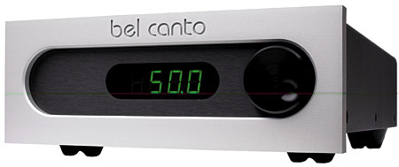

Βel Canto Dac3
Ψηφιακές είσοδοι: Coaxial (RCA/BNC), Toshlink, AES/EBU, USB
Αναλογικές έξοδοι: Single Ended, Balanced, με δυνατότητα ψηφιακής ρύθμισης της στάθμης
Ψηφιακό τμήμα: Upsampling στα 24bit/192kHz, διπλό PLL, DAC PCM1792A (Burr Brown)
Αναλογικό τμήμα: μετατροπή i/v με LT1468
Aλλες δυνατότητες: Διαθέτει τηλεχειριστήριο

Review του Βel Canto DAC3 από το Stereophile. Ενθουσιασμένος ο Atkinson. Δείτε τις μετρήσεις.
"The DAC3 . . .
. . . is one of Bel Canto's e.One series of components, and is a relatively small device. Its half-width front panel features a central green display and, to its right, a black volume-control knob, both housed within a radiused recess. At the top of the rear panel are the IEC AC mains jack and five digital inputs: a transformer-coupled AES/EBU input on an XLR jack; two transformer-isolated electrical S/PDIF inputs, one on an RCA jack, the other on a BNC jack; a TosLink optical jack; and a standard USB port. (The last is said to be galvanically isolated so that electrical noise on a computer's ground doesn't affect the DAC's performance.) There are two pairs of analog outputs: a balanced pair on XLRs and an unbalanced pair on RCAs. A small pushbutton selects between fixed and variable output level.
Inside the black-painted steel chassis, the audio circuitry is carried on a single lead-free printed-circuit board behind the rear panel. A second board carries the quite beefy power supply, this based on two toroidal transformers and four voltage regulators mounted on heatsinks. A small PCB mounted vertically behind the front panel contains the display and control circuits, while another small board behind the rear panel's digital input jacks carries the ground-isolating data transformers and the USB receiver. The last is based on a Burr-Brown PCM2903 chip, which includes both 16-bit A/D and D/A converters, though here it appears to be used to convert the USB datastream to S/PDIF, clocked by an adjacent crystal. The selected input datastream is sent to the ubiquitous Cirrus Logic CS8416 receiver chip.
The heart of the DAC3 is a Burr-Brown PCM1792 two-channel DAC chip, a CMOS type with a specified 24-bit resolution using BB's Advanced Segment DAC architecture. (The six most significant bits are processed by a conventional D/A section; the 18 least significant bits are decoded by a five-level delta-sigma D/A section running at 64 times the clock speed.) The chip has onboard digital attenuation and a soft mute, both of which are used by Bel Canto, as well as slow- or fast-rolloff reconstruction filters. It will also process DSD data, though Bel Canto doesn't implement that option. Although the PCM1792 will handle data sampled over a wide range of frequencies (10–200kHz), Bel Canto runs it at a fixed sample rate of 192kHz, feeding the chip from the output of a high-quality asynchronous sample-rate converter chip, a Cirrus CS8421, which upsamples the coming data. This topology is increasingly popular—I've seen it used in processors from Benchmark and Musical Fidelity—because it provides an additional stage of jitter reduction. Bel Canto also describes the DAC3 as using a proprietary Ultra-Clock circuit, a master clock generator with very low levels of jitter.
The DAC3 uses a single PCM1792, though it should be noted that the chip can also be used in dual-differential mode (one per channel) to give 3dB lower noise and thus greater resolution. The DAC's four current outputs (left hot/cold and right hot/cold) are each transformed into a voltage signal by what appears to be a combination of a high-precision Caddock resistor (footnote 1) and a Linear Technology high-speed op-amp; this stage in turn feeds the output stage, which is based on high-quality Burr-Brown OPA1632 differential-output op-amps.
Summing Up
I so wish that Bel Canto's e.One DAC3 had been priced closer to $1250 than to $2500. The former would make it a no-brainer credit-card purchase for almost any audiophile wanting digital playback quality that is the state of the art ca 2007. At $2495, its purchase should be a more considered decision. But its superb sound quality, excellent engineering, and the fact that its volume control makes a system preamplifier optional, all make the DAC3 a must-have product. Erick, you were so right!"
Και από τον πάγκο του Atkinson:
"Other than the jitter performance via its USB input, the Bel Canto e.One DAC3 is the best-measuring digital component I have encountered. It offers some impressive audio engineering in both the digital and analog domains." -- John Atkinson
Full Review: stereophile.com
