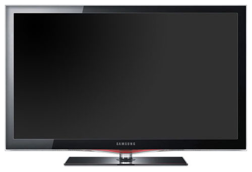

Από τη μεσαία σειρά της Samsung έρχεται η 650.Χωρίς led,αλλά σε προσιτό κόστος και με πολύ καλή(κατά πως φαίνεται απ το τεστ) εικόνα,εξαιρετικό μαύρο και χαμηλή κατανάλωση.
Μειονέκτημα οι επιδόσεις σε gaming.
Review:hdtv.co.uk
Conclusion
Although we were ready to give the Samsung LE40C650 a “Highly Recommended” verdict, a few smaller issues prevented us from doing so. 45ms of input lag makes the LCD TV unsuitable for hardcore gamers, and some mild undefeatable video processing alters the aesthetic of grainier film material rather than faithfully reproducing it — something which will likely infuriate film purists in principle alone, even though it is a characteristic of the TV which many people will not notice. In the future, we’d also like to see Samsung’s very promising Motion Plus system refined to avoid the slight added judder which we encountered with it enabled.
In terms of contrast performance and overall picture depth, the Samsung LE40C650 is one of the best LCD HDTVs we’ve ever reviewed, and indeed is even better than some Plasma displays. The addition of 10-point Greyscale configuration is a fantastic addition to Samsung’s already comprehensive set of picture setup controls, and is one of the reasons why the LE40C650 calibrated so wonderfully, with ruler-flat Greyscale and Gamma tracking (and let’s not forget the highly accurate colour reproduction). All of these traits resulted in very realistic, satisfying video. LCD buyers who have been left disappointed with the contrast performance of other displays will find a lot to like with the Samsung LE40C650’s deep blacks and satisfying image… it only narrowly misses a “Highly Recommended” rating for the reasons cited above.
Tιμές:37'',40'',46'',55''.
