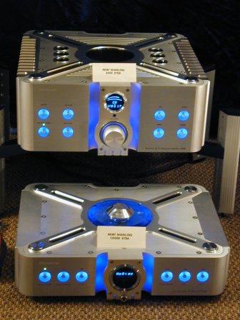

Αν μη τι άλλο η νέα σειρά 500 τηε shanling έχει εντυπωσιακή εμφάνιση. Αν την συνδιάση με καλή απόδοση και με τις καλές τιμές που συνήθως έχουν τα shanling έχουμε ενα σετ που θα απασχολήσει πολύ κοσμο...
Reference A500 Integrated Amplifier Specifications
● The separate power supply for pre-amp at 150W and amplifier at 800W by two power transformer, eight big 10000UF ELAN capacitor as filter purpose.
●MOSFET of K1529 and J200 as current drive for the amplifier, six pairs of Sanken power transistor of 2SA1295 and 2SC3264 in parallel as big power output.
●Available to set full balance as single channel output, and the pre-amp and amplifier can be used separately.
●Dynamic bias control: It will be Class-A amp when the power output is lower than 20W, and it will be Class A.B when the power output is higher than 20W.
●Hi-End heat sink in a custom-made, the special construction in full shield for pre-amp, and the main control knob have a good feel in operation.
●Full aluminium alloy body in configuration, the weight is reached 50Kg.
PARAMETER:
RATED POWER OUTPUT:2×260W/8Ω, 2×400W/4Ω, 2×600W/2Ω or 1×500W/8Ω
S/N:≥110dB(WEIGHTED A)
TOTAL HARMONIC DISTORTION):≤0.02%(额定功率-6dB)
DIMENSION:482(w)×482(d)×180(h)mm
Weight:50kg

Reference CD500 CD Player Specifications
★The special custom-made servo system CDM1230 for CD500 by Shanling.
★Japanese NPC SM5847 over-sampling and filter chip.
★Burr-Brown SRC4193(44.1KHz/192KHz) upsampling chip.
★Four Burr-Brown PCM1704K D/A converter chips, two per channel for full balanced output.
★ Two EH6922 vacuum tubes with gold plated pins for Analog balance XRL output.
★Single RCAX1 and Balance XRLX1 audio output ports.
★Coaxial RCA and Digital balance AES/EBU digital output ports.
★Two R style power transformer in a custom-made, the separate power supply for Digital and Analgo electrocircuit.
★Full aluminium alloy body in configuration, the weight is reached 16Kg, and the top loading system have multiple anti-vibration construction.
PARAMETER:
FREQUENCY RANGE:20Hz-20KHz(±0.2dB)
S/N:≥115dB(A计权WEIGHTED A)
TOTAL HARMONIC DISTORTION:≤0.02%(1KHz)
DIMENSION:482(w)×360(d)×100(h)mm
Weight:16kg
