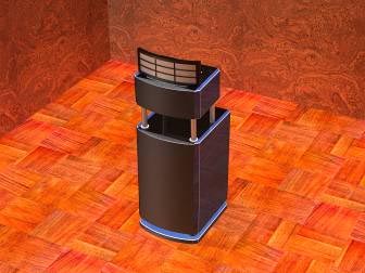

Career audiophiles with deep pockets know about Siltech. Fewer will know that Siltech has long since assembled a very exotic and expensive cache of measurement hardware that continues to guide their ongoing research. The latest measurement-driven exploit by Edwin van der Kley and team is the forthcoming Pantheon XXV limited-edition reference speaker which celebrates the company's 25th anniversary.

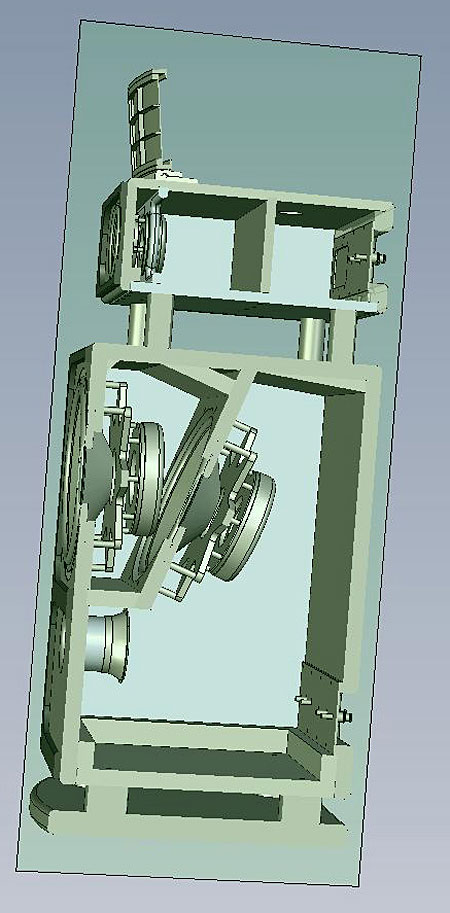

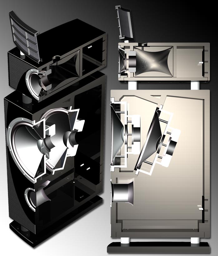

On first glance, the visible ingredients, while top shelf and heavily customized, don't seem completely unusual: multi-faceted and movable ESL tweeter panel; 7" dynamic midrange in discrete enclosure; isobarically loaded 16" woofers in separate bass enclosure. What is unusual are the stout claims for uncommonly room-invariant behavior. Anyone considering the presence of twin 16-inchers per side might swallow hard.
While the public launch of Siltech's Pantheon XXV in Holland won't commence until September 18th when 50 members of the audio industry are invited to witness the presentation, the promise that ultra-sophisticated computer simulation might have advanced the art of loudspeaker design in how endowed bass systems interact with the listening environment is exciting even prematurely ...

Παρουσιάστηκε και επίσημα το Pantheon της Siltech το οποίο θα μπορέσουν να το αποκτήσουν μόλις 39 τυχεροί audiophiles (sic).
Σύμφωνα με τον κατασκευαστή, ο στόχος τους ήταν να δημιουργήσουν ένα ηχείο με τα παρακάτω χαρακτηριστικά:
...room-invariant bass response; a nearly resistive load (4/5-ohm impedance remains within +/- half an ohm over the entire bandwidth); a phase-correct network (a 10-part acoustic 4th-order); minimal distortion; very high damping (bass Q at 0.38, midrange Q at 0.5); extreme SPL potential of 120dB; controlled directivity; and benign 90dB sensitivity.
Σίγουρα φαίνεται ενδιαφέρον.
Αρκετά με το οφθαλμόλουτρο!
Περισσότερες πληροφορίες για το ηχείο και κάποιες πρώτες ακουστικές εντυπώσεις (καθώς και φωτογραφίες απο τους χώρους τις Siltech) θα βρείτε εδώ: 6moons.com
Στην παρουσίαση ήταν και ο John Atkinson του Stereophile οπότε το πιθανότερο είναι να διαβάσουμε κάποια στιγμή και τις δικές του εντυπώσεις.

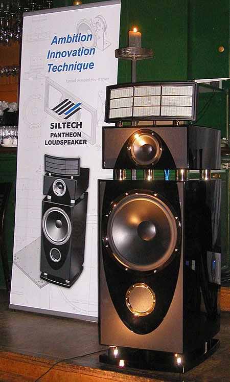

There, in the restaurant associated with Arnhem's historic Roosendael Castle, Edwin unveiled the Pantheon to an assembly of journalists, dealers, and distributors. The Pantheon is intended to be the flagship of a range of speakers, and will cost upward of $120,000/pair in the US. Weighing 310 lbs and standing 63" tall, the speaker combines a pair of isobarik-arranged 16" Audio Technology woofers in a large, reflex-loaded bass bin with a 7" AT midrange unit in a separate enclosure, and a curved, 19" x 5" electrostatic tweeter. Internal wiring is, of course, all Siltech G7 silver-gold alloy, and the fourth-order crossover features 5.5 lb air-core inductors and high-quality capacitors.
The woofer tuning is unusual, in that the design goal for the system Q was very low, 0.5 with the port open, 0.38 with it closed. This overdamped alignment, optimized with extensive computer modeling of the speaker's interaction with the room acoustics, is essential, Edwin van der Kley feels, due it its tuning not being adversely affected by room resonant modes. Even with this low Q, the Pantheon's bass extension is said to be a low 18Hz, –3dB. The speaker's overall directivity is said to be carefully controlled. All the design work was perfomred using a set of analytic programs from Comsol in Sweden.
The very low-mass, high-sensitivity tweeter has a diaphragm just 0.03mm in thickness and is specified as having useful HF extension to 39kHz. It is sourced from Cadence in Pune, India, the high-end division of one of the sub-continent's largest speaker manufacturers, and it emerged in conversation with the van der Kleys and Cadence's managing director, Ajay Shirke, that the Indian company has taken a partnership interest in Siltech. Certainly, Edwin (right in my photo) looks pleased with the turn of events, while Stereophile contributor and erstwhile Hi-Fi News editor Steve Harris (center) and current Hi Fi News editor Paul Miller (left) examine the Pantheon close-up.
Considering its bulk, the Pantheon looks extremely elegant, thanks to the styling, the result of the work of Traditional Arts Ltd, a London-based associate of the Prince of Wales Charity Foundation. The lustrous, hand-finished piano-black lacquer is complemented with either aluminum or gold-plated metal parts, and is finished off with a trim of bull-hide leather from Hulshof Royal Dutch Tanneries.

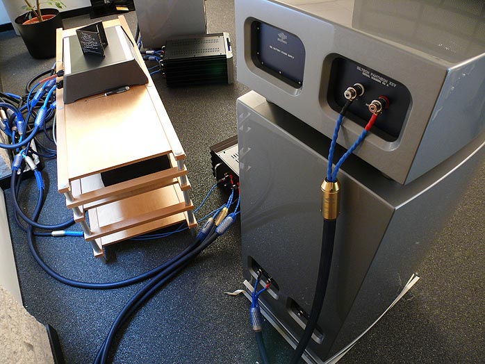

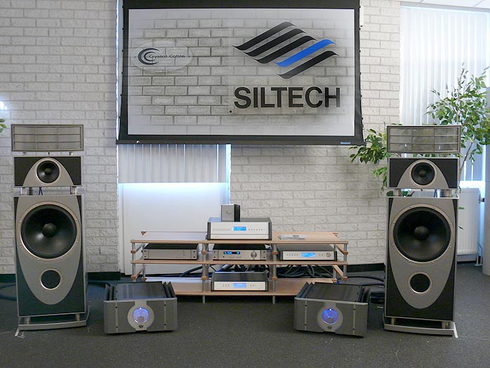

πιο πολυ μου αρεσει το φυτο στην πρωτη φωτο και οι μπορνες:happy_4:
1.935
13
Εγω θα γουσταριζα το γιγαντιαιο ψυγειο λαδιου που εχει στην κορυφη, να το βαζα στο μηχανακι.
Επισης σατανικη επιννοηση ειναι η καβαντζα για τα τιμαλφη στην πισω μερια της καμπινας του Midrange.
Πλακα πλακα ειναι θηριωδες κατασκευασμα.
