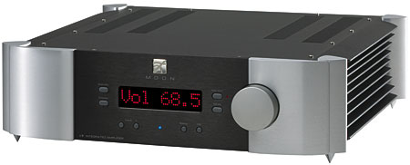

"The Moon Evolution i-7 is one of Simaudio's statement products: a good-looking, surprisingly heavy (58 lbs), solid-state integrated amplifier built into an aluminum alloy chassis more or less equal in size to that of the SuperNova CD player, which Wes Phillips wrote about in the January 2007 Stereophile. The i-7 comes with a nice-looking remote handset, built into a molar-shaped alloy enclosure so heavy that, when I accidentally dropped it, it dented the floor. Seriously.

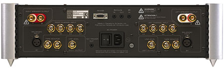

The i-7 is fully balanced, although the single-ended inputs outnumber their balanced counterpart four to one. There's also a tape loop, a pair of auxiliary line-level outputs (their output impedance is a low 50 ohms), special jacks for communicating with other Simaudio products, and a nine-pin RS-232 port: something else I don't know much about.
A large knob off to the right actuates an optical encoder, which itself selects among many combinations of metal-film resistors for signal attenuation. (The knob is also used as a selector switch during the setup routine.) This is Simaudio's M-eVol, a resistive-array circuit with 130 discrete steps, intended to avoid the distortions associated with old-fashioned potentiometers. The M-eVol system is also speed-sensitive, which is something no potentiometer can match: In the lowest portion of its overall range, from 0dB to 30dB, loudness is adjusted in 1dB steps; above that, the speed with which the knob is turned determines whether loudness is to be adjusted in steps of 0.5dB (slow turning) or 1dB (quick turning). Incidentally, the mute control works not by clamping input signal to ground, but by instantly switching the M-eVol system to zero—from whence it can, of course, be switched immediately back to the previous setting.
The Moon i-7 lacks a mono-blend or channel-reversal switch. Side-to-side balance is adjustable, but only from the remote—which makes more sense than doing it while standing next to the amp itself, I suppose. In any event, the user can adjust the left-to-right loudness differential in accordance with a hundred small steps; that was certainly enough for me.
