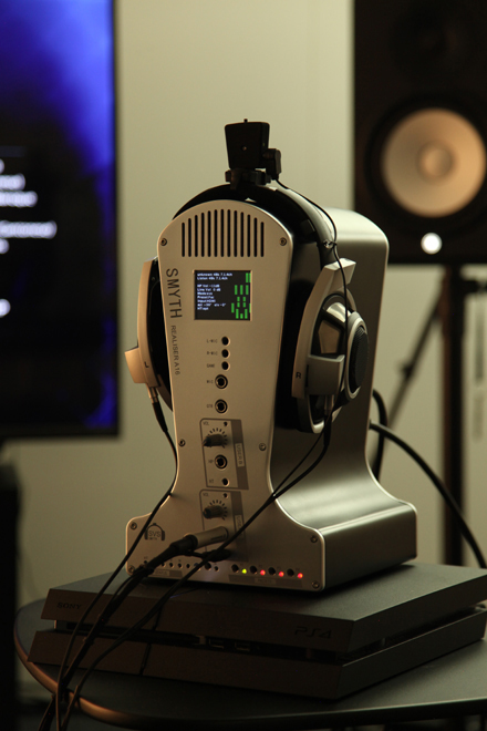

The Realiser-A16 audio processor re-creates immersive 3D audio over stereo headphones, rendering up to sixteen virtual loudspeakers in any location, with head-tracking.
Personalisation allows the virtual sound room to sound identical to the real room.
  • Professional grade accuracy
  • Built in measurement routines and hardware
  • Measure any loudspeaker format
  • Low-latency high-speed head tracking
  • Personalised headphone equalisation
The SVS technology that drives the Realiser A16 3D sound processing was developed specifically to allow owners to conveniently capture personalised sound room measurements. These measurements are undertaken by inserting the supplied binaural microphones in each ear canal, and then sitting in the sound room sweet spot while test sweeps are played from each of the loudspeakers. The entire process takes only a few minutes and the resulting measurement data is used to create, what we call, a personalised room impulse response (PRIR) file. This PRIR file exactly describes how each loudspeaker sounds to you when sitting in the sweet-spot and, when it is loaded into the SVS processor, it allows the A16 to reproduce the very same loudspeaker sound using only your headphones. We describe loudspeakers generated over headphones as virtual loudspeakers since they are not real but just an illusion, albeit a highly accurate one. Throughout our discussion of the A16 we refer to PRIR files as virtual sound rooms since PRIR files are really just a collection of virtual loudspeakers playing in a virtual room.
