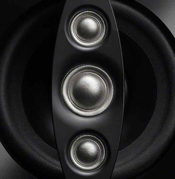

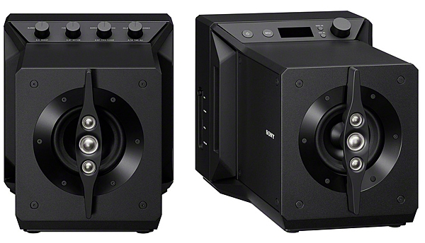

The SA-Z1 system consists, of course, of two speakers. Each one contains a ¾" tweeter with a titanium-sputtered soft dome flanked vertically by two smaller, similar tweeters, all mounted on a narrow, tapered plate in front of the front baffle. Mounted on that front baffle is a 4" forward-firing woofer with an anodized aluminum cone; behind that is a similar 4" woofer that faces to the rear. Various buttons and controls sit atop each speaker
The SA-Z1 offers several options for digital playback: automatic upsampling of "Red Book" PCM files to high-rate PCM (32/384 for files input by USB; note, however, that all data eventually ends up as PWM, aka DSD); resampling of PCM to high-rate DSD (DSD256 when input via USB; this is called DSD-RE, for DSD Remastering); straight playback of DSD files; or what Sony calls "optional enhancement of compressed music" via the company's "Digital Sounds Enhancement Engine." "DSEE-HX" attempts to restore what's been lost from compression with a combination of upsampling and what Sony calls "harmonic restoration."

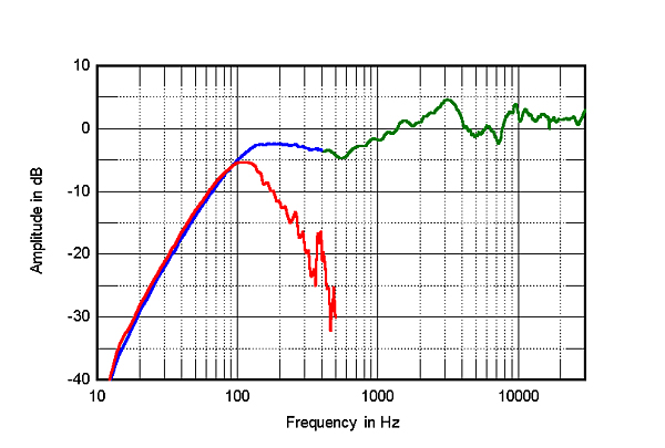

Sony SA-Z1, analog input, anechoic response on central tweeter axis at 50", averaged across 30° horizontal window and corrected for microphone response (green), with the nearfield responses of the front woofer (blue) and slot-loaded rear woofer (red) plotted below 500Hz

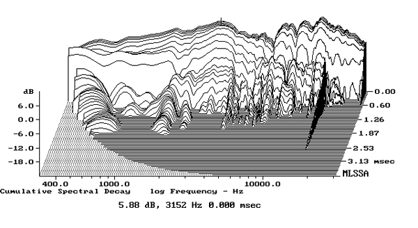

Sony SA-Z1, analog input, cumulative spectral-decay plot on central tweeter axis at 50" (0.15ms risetime).

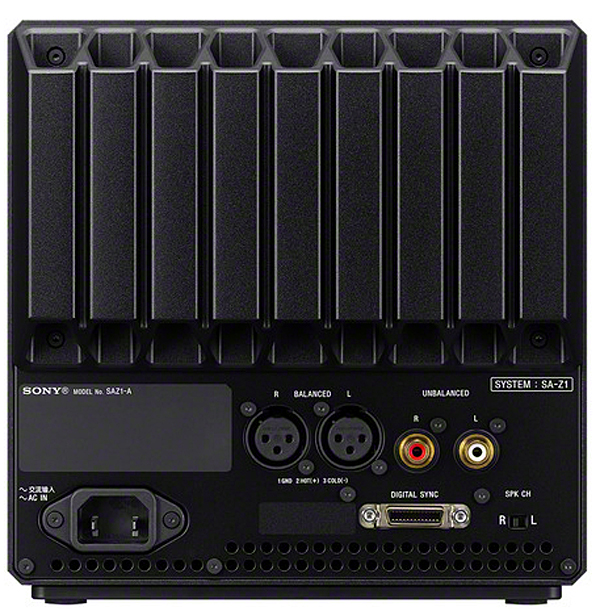

Description: Nearfield active speaker system for desktop listening. Drive-units: ¾" (19mm) titanium-sputtered soft-dome tweeter, two 9/16" (14mm) titanium-sputtered soft-dome tweeters; two 4" (100mm) anodized-aluminum–cone woofers. Crossover frequencies: 5kHz, below 200Hz (adjustable, for assist woofer integration). Inputs, digital: USB-B, Walkman/Xperia, TosLink. Inputs, analog: XLR, RCA, Stereo Mini. Total amplifier power: 106W. THD: 0.03% (1kHz, 10W). Frequency range: 10Hz–200kHz. S/N ratio (A-weighted): 100dB. Power consumption, active: Speaker A, 60W, speaker B, 50W. Power consumption, standby: 0.5W each. Through USB-B input, accepts DSD native up to 22.4MHz, DoP up to 11.2MHz, PCM up to 32/768; through Walkman/Xperia input, accepts DSD native up to 11.2MHz, DoP up to 5.6MHz, PCM up to 32/384; through TosLink input, handles PCM up to 24/96.
Dimensions: Speaker A: 7 7/8" (199mm) W × 8¼" (207mm) H × 12 7/8" (326mm) D; Speaker B: 7 7/8" (199mm) W × 8 1/8" (205mm) H × 12 7/8" (326mm) D including projecting parts and controls. Weight: 23lb (10.5kg) each.
