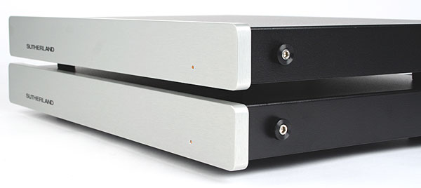

Once I'd opened the cartons, I saw that the Duos were built into the same small casework used for Sutherland's Insight stereo phono preamplifier, rather than the one used for Sutherland's other mono models. Other than size, the Duos' cases mirror the larger ones. They're built of the same powder-coated, heavy-gauge steel with a faceplate of ½"-thick anodized aluminum, the latter's surface interrupted by only the Sutherland logo at lower left and, at lower right, a single LED to indicate that the unit is powered on.

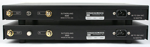

On each rear panel are one RCA jack for input, another one for output, and a grounding post for a turntable. As with all Sutherland designs save the Argentum Plus, the Duo has no provisions for balanced operation. There's also an IEC receptacle for a power cord, but only a basic AC cord is supplied. Says Sutherland, "Most customers are going to use one they pick, so why add the cost?"

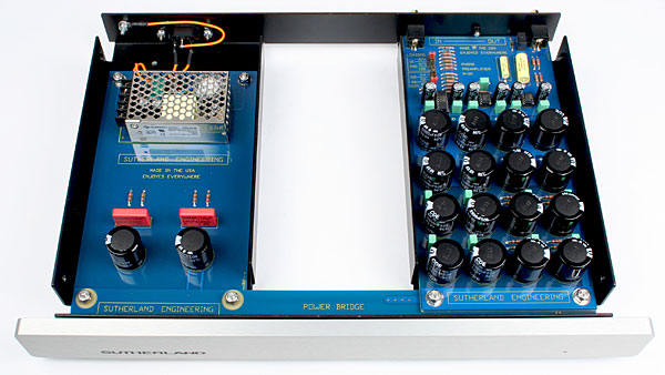

The Duo's internal layout is similar to the PhonoBlock's, with separate subchassis for the power supply and audio circuits, and a single connection between the two. The connection in the considerably more expensive PhonoBlock is elegant: a ribbon cable running inside the faceplate; the Duo's subchassis are instead connected by circuit board labeled Power Bridge. Some may see this as a less elegant approach, but it's way cooler. Not surprisingly, the Duo's circuitry is much less complex than the PhonoBlock's. Rather than the PhonoBlock's linear supply, the Duo's supply is based on the internal switching supply first seen in the Insight.
Loosening four thumbscrews allows the casework cover to be removed, to gain access to the sockets and jumpers used to set the cartridge loading and gain. There are five possible loading values, ranging from 100 to 47k ohms, and the choices of gain level are 40, 46, 52, 58, and 64dB.
Every aspect of the Duo's construction reflects the superb quality seen in other Sutherland models. The boards are sheer engineering artwork, adorned with such audio jewelry as Dale/Vishay 1% metal-film resistors and 1% polystyrene film capacitors, the latter custom-wound to Sutherland's specs. The boards themselves are made of the same 1/8"-thick FR-4 fiberglass used in the PhonoBlock, the thicker material being Sutherland's simple, elegant way of eliminating the capacitance created in a typical 1/16"-thick board bearing circuits on both sides.

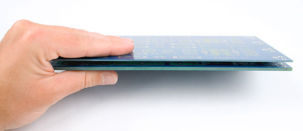

image: https://www.stereophile.com/images/917sutherland.ins.jpg
The Duo's operation is simple and intuitive, and the two of them worked perfectly during their time with me. As with all Sutherland products, the Duo's conservative design and superb build quality strongly suggest that it will prove bulletproof throughout a long and happy life.
