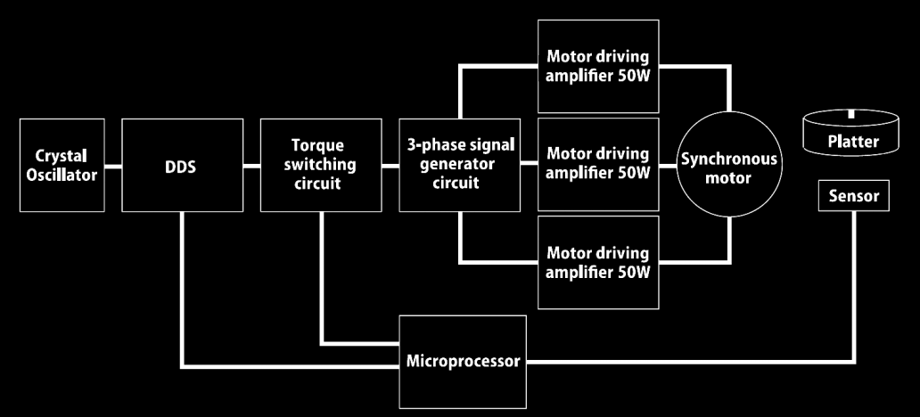

TechDAS's goal for the motor was to produce "virtually zero wobble" thanks to the combination of air and metal bearings, the "enormous" inertia generated by the flywheel effect, the extremely high S/N ratio made possible by the air bearing, and what TechDAS claims is the best speed stability and consistency of any Air Force turntable—the latter due to a new electronic drive circuit designed for stable, precise rotation with low vibration

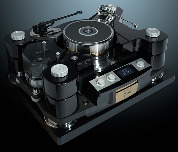

The Zero is the most speed-consistent belt-drive turntable I've reviewed, and with its air-bearing platters and air suspension, also the quietest, best isolated, and most inert, with stable sonics, quiet, and exceptional detail resolution with no added grain or unnatural, mechanical edge definition. The Zero was also trouble- and hassle-free for six months and as much fun to use as it was to hear

Base Frame100 kg, stainless steel
Platter Base35 kg, extra super duralumin
Platters100 kg in total

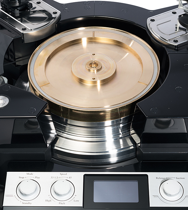

Bottom platter33 kg, Ø 40cm, forged Stainless Steel SUS 316L
Second platter20 kg, Ø 31 cm, forged Stainless Steel SUS 316L
Third platter20 kg, Ø 31 cm, cast Gunmetal
Fourth Platter20 kg, Ø 31 cm, forged Stainless Steel SUS 316L
Top Platter7 kg, Ø 31 cm, Titanium with special surface hardening treatment
Total moment of inertia16,000 kg/cm2
Drive systemBelt-drive, polished and non flexible polyurethane fiber belt
Drive MotorDrive Motor: 3-phase 12-pole AC synchronous motor manufactured by Papst, Germany (1000/5001)
During a startup and adjustment of the rotation, high torque rotation
In a stead-state rotation, non servo, low torque, ultra low vibration
Rotation speed33 1/3 rpm / 45 rpm, precise speed adjustment function
Wow & Flutterbelow 0.03%
SuspensionAir suspension, air charged by an electric air pump with built-in Power Supply Unit
Main Unit Dimensions including Motor902 (W) x 677 (D) x 335 (H) mm
Distances between center point of base frame feetfront left foot – front right foot 67 4mm / rear left foot – rear right foot 722mm
front left foot – rear left foot 461 mm / front right foot – rear right foot 441 mm
Total weight of Main Unit including Motor330kg (Power Supply / Air Pump Units are not included)
